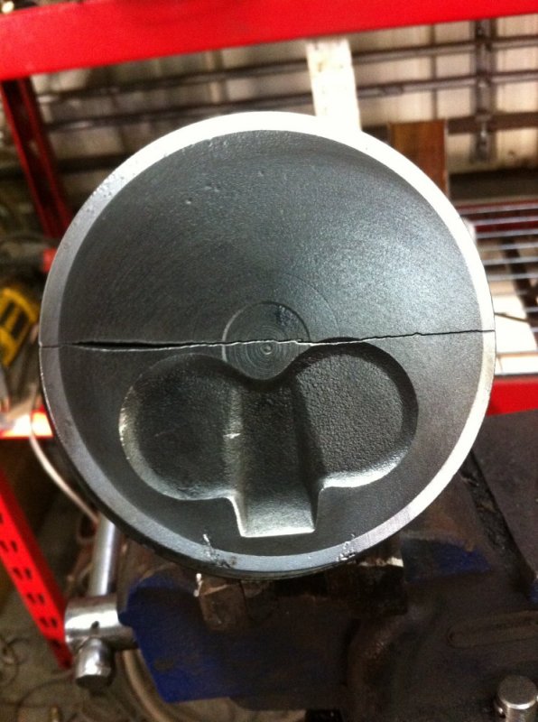

Did your piston look like this one? This was #6, bad injector caused it.

This is my cracked #8. Picture isn't great but it does look similar to yours

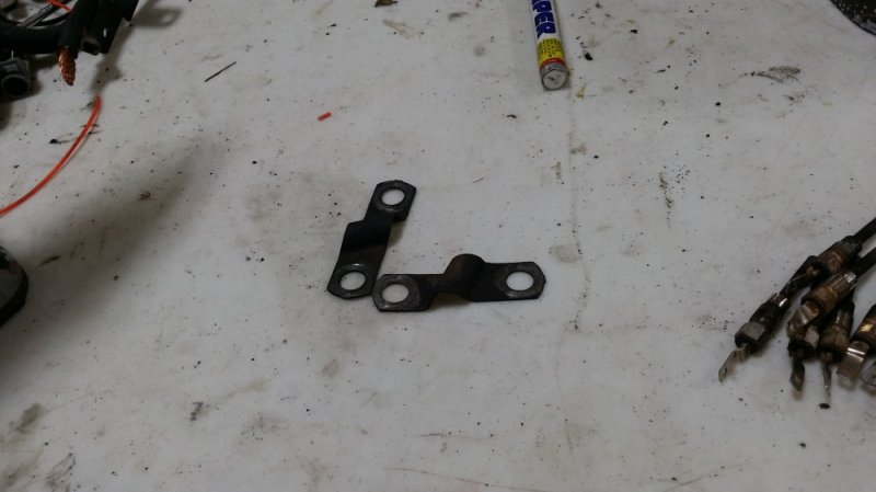

Anyone know what these brackets do? Cleaning up & I noticed them off the #141

Those are for the Injector line's. The intake Manifold bolts go through them.

Figured they had something to do with the lines.
Yes, one under & one over the lines... keeps vibs from cracking lines...
Found this a mystery because the #506 doesn't have any and there aren't 6 more to go with the other lines

These are off the #141 with the cracked piston. Them, & a 10mm nut are the only parts unaccounted for. Considering this is my 1st engine swap, if say that's pretty damn good
Newer ones had plastic clips and did away with the metal ones .

The injection lines have rubber "dampers" in them and are held down by the intake manifold bolts. Where the injection lines pass through the intake runners there should be a damper/clamp. IMO I haven't had them on in forever as I pull the intake too often... The dampers are not all the same for example the ones in front are held by a single bolt. Do not let any injection line contact metal as the high pressure vibration from fuel pulses will wear a hole in them. Never-mind the noise it could cause.
