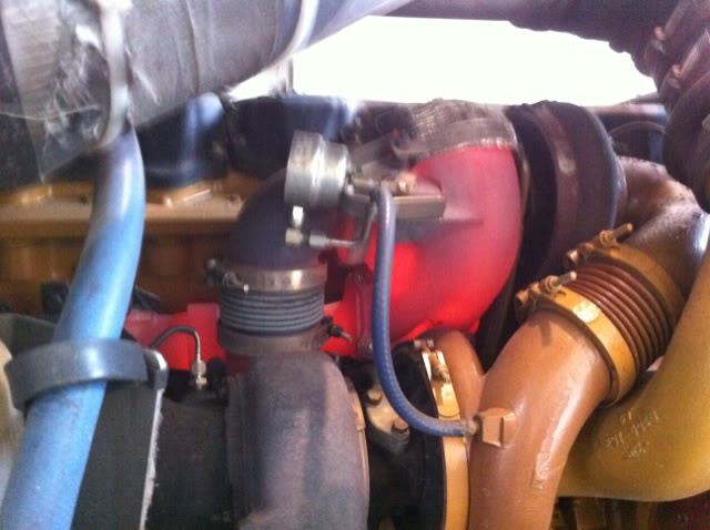

In general check airflow from dirty air filter sucking in hot underhood air to a restricted exhaust. Burning engine oil also can raise EGT and make the turbo glow.
Example of turbo glow on a CAT C15.
