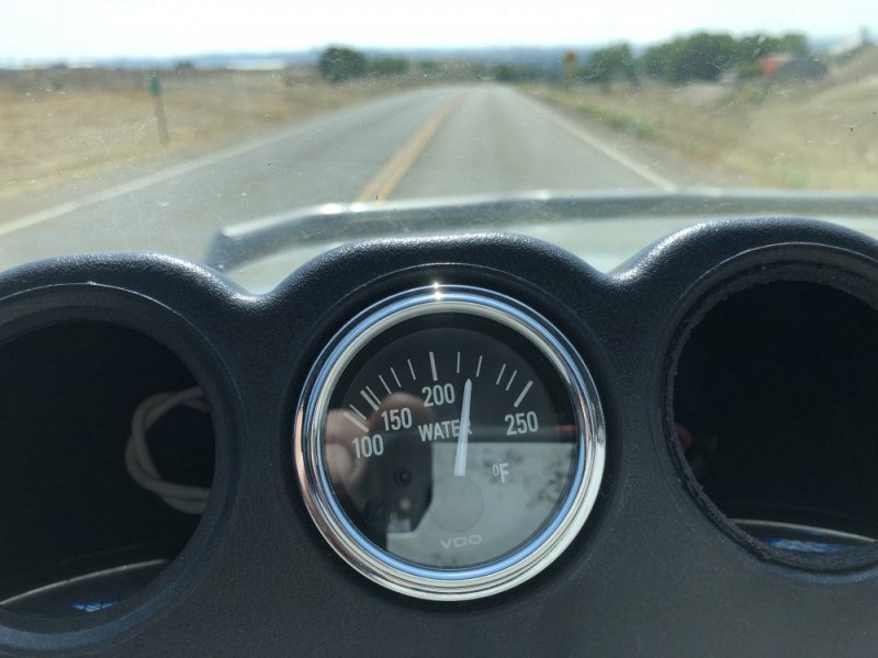

Outside temps was about 95, went for a drive. Temp gauge climbed to right at 210 on the dash gauge.
Gauge connected to the RR cylinder head was right next to 220. Still never heard the fan clutch kick in. Got home and opened the hood, fan was spinning but at what rate with RPMs ? 🤷‍♂️ 😹😹😹

No fan roar. Temp gauge back up to just below 220 degrees. Pulled off the road, let it idle for about a half a minute to spool down the turbo, shit offt duh switch, popped duh hood, grabbed a fan blade and the blade spins easier with the engine hot than it did with the engine at room temperature.
