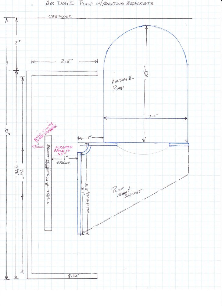

@Big T Found this diagram I drew up for planning on clearing the 2.5” frame rail edges to get the space.

I went back over the thread I linked above and if you go back one page to posts 156, 158 & 159 there’s more pics of the mounting fab process. Post 157’s images no long load. Feel free to call Amigo.
