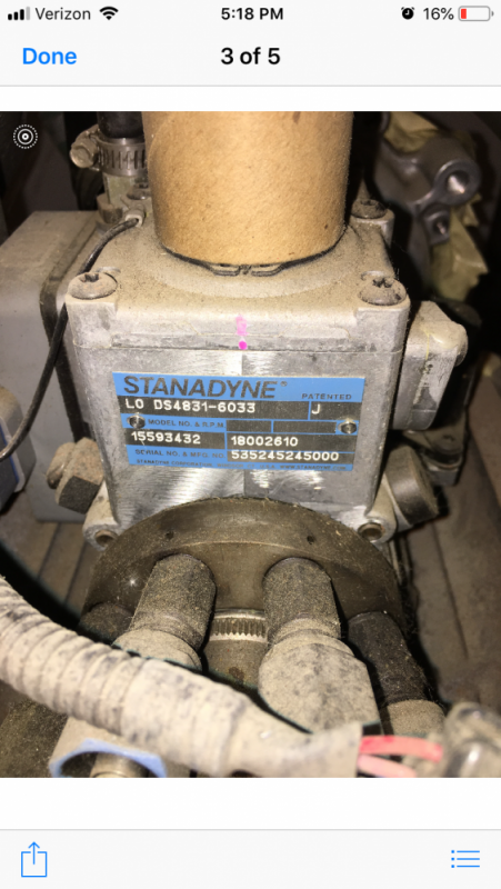

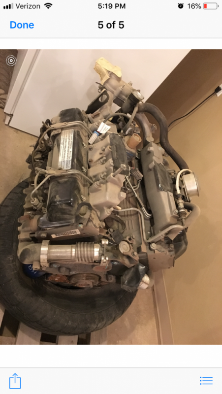

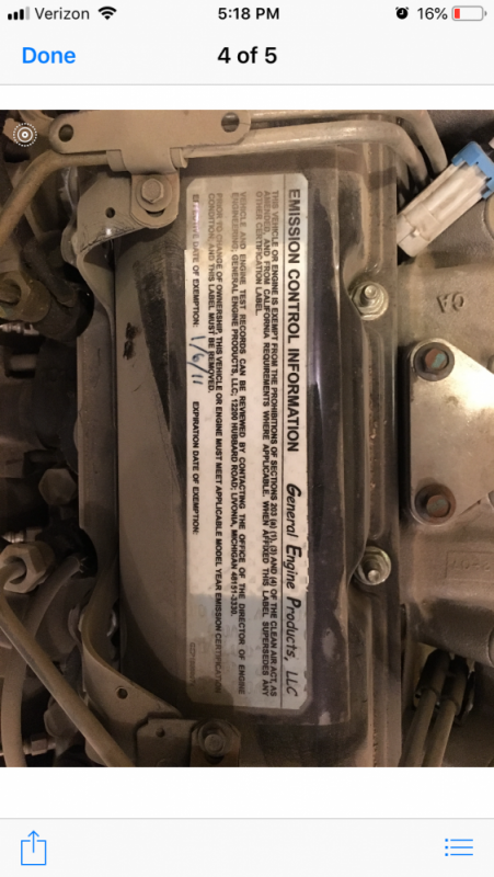

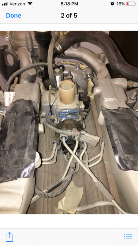

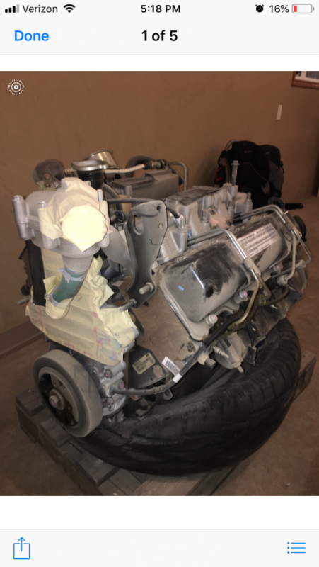

Here is the pics he texted me on it. Nice guy named Kyle.

Hello, just signed up as Will instructed me to do some research. Is anyone confident on what that ds4 is and if I can utilize it for my p400 build or as a spare? Hoping it isn’t a paper weight.
He is the guy I posted about. That is his p400 with the 24v ds4831-6033.
Hopefully if nothing else he could salvage the head and rotor as backup for his other ds4. But it has some run time then has been sitting for years. I have concerns over damage from not being flushed before storage.
@hithere can you post a pic of your ip tag currently on your hummer?
from everything I read the head and rotor are the same but most of the internals are slightly different. The cam ring being the most obvious difference.I'd be interested in the IP if he decides to scrap it
I can't find a parts breakdown anymore for the ds pump, but from what I could find it looks like the fuel cutoff solenoid is about the only difference between the 12 volt and 24 volt ds pumps. The 04 optimizer used a 12 volt version of this special ds/de hybrid pump according to a tech bulletin I could find. I did find that all the DS pumps use the same electrical simulator to run them, and the only notes it said between 12 and 24 volt was to use the 12 volt pmd for the test stand(the tester uses a mechanical shut off valve for calibration purposes).
