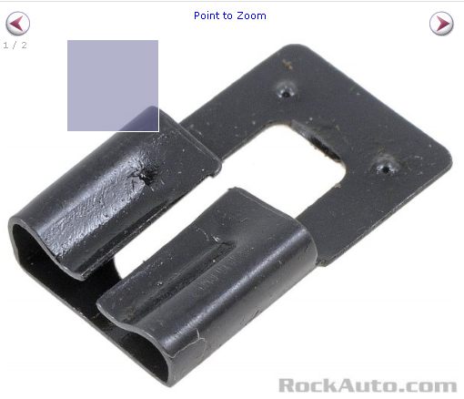

Would it be this:
Would that slide on the mushroom head of the rod after it's stabbed into the lock button?
I also have two plastic slides that the rods are supposed to run in. Neither will work when in those slides. The lock actuator motor loses full throw when the rod is in the clip towards the door handle. Am I doing something wrong?
Maybe I'm not remembering correctly, the ones I'm thinking of are all plastic and part of the bushing the rod slides into. Haven't been into the gmt400 ones recently enough to recall for sure
