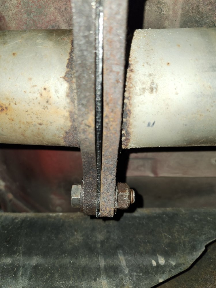

As you can see, I have a gap after bolts are tight. Can the gasket between the downpipe flanges be doubled up?
The metal has deteriorated and scaled away.

Doubling gaskets on an exhaust leak will more than double the leak. The exhaust will burn out the gaskets even quicker than one gasket.
Best to make a sanding block with a 2X4 maybe three or four inches long. Staple 80 grit or courser to the block and sand away the high spots.
The only way to make it work is to make both sides to come together on a parallel basis.
Problem is: someone over tightened it and bent the flanges. Straighten the flanges, grind/sand them flat as mentioned above. A far faster and far more dangerous method than block sanding is use a grinder with new wheel on it. But you have to be flat- so when you can find a way to clamp them together lightly on both sides of the disk it works well.

What I see is a gasket failing BECAUSE the flanges are bent.

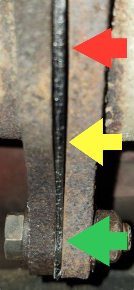

Zoomed in on your picture:
Green arrow flanges tight (over tight actually) and zero gap.
Yellow arrow flanges are beyond the fulcrum and have spread apart allowing a small gap.
Red arrow flanges are flexed apart with a large gap. This gap is large enough that it is not holding pressure against the gasket material enough to retain the pressure allowing the failure of the gasket.

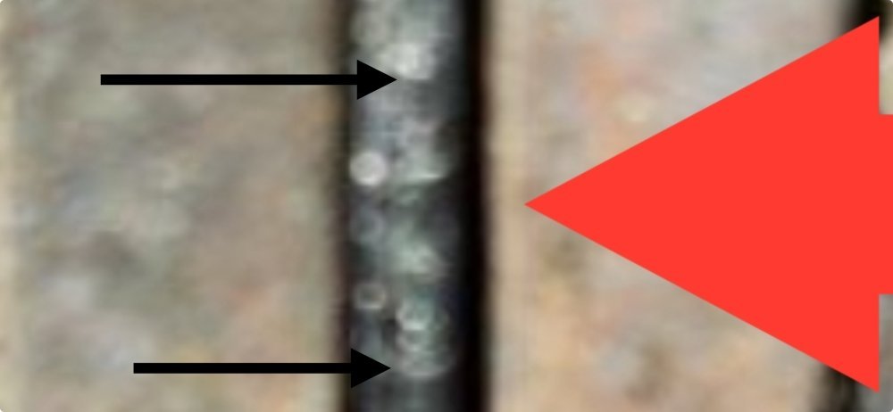

Second picture:
Look at the two black arrows where the tips of the arrows line up. There is a vertical line in the gasket. That is where the gasket blew out under pressure because it wasn’t being held together tightly enough there.
Put a straight edge against the inside edge of the flange and use a feeler gauge like you test a head or block for straightness and you will see the warp. This is a common error that occurs. I did my share of over tightening these and a couple header collector flanges along the way. Could be where I learned the 8” grinder trick…

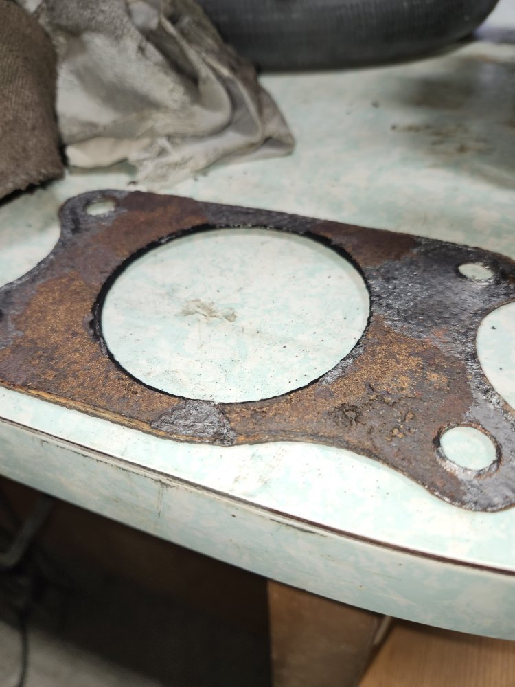

The gasket in the picture is the new one. The previous one is in the other image but didn't blow out. There was no exhaust leak.
The steel has delaminated. Notice the steel on the old gasket.
That said, I went back and checked the flanges for warp. They are indeed warped. I checked them on the side opposite the mating surfaces. What I don't know is if that happened when it was installed originally or if the delamination caused it when the center began to "grow".
The flanges have lost 1mm of thickness in the center of each. This is the material stuck to the old gasket.
I took the downpipe back out (which is a chore all of its own. I have no idea how I maneuvered it up there yesterday but I am pretty sure it was different from how I got it out) and squirted panther piss on the clamp hardware in case there is the slightest chance it will come apart. It will be best to do the work on the floor instead of up overhead. I think we will try to heat the flanges to try to straighten the mating surfaces. Might still need to grind the surfaces but would rather keep all the metal thickness I can.
