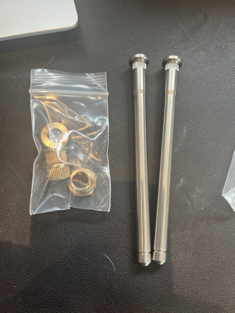

Doing a little research on door hinge pin replacement on the GMT 400 era trucks, and came across this excellent video
Fast forward to the end and he experiences the exact same bushing break-up that I did and in short order. Lot of comments about the crappy Dorman bushings with some recommending GM only bushings. Then finally someone came up with a source for solid bronze heavy duty bushings:
They ain't cheap at $30 per door, but you get what you pay for. I ordered 2 sets because I'm tired of messing around. They even offer oversized bushings for door hinges that have worn.
Will let y'all know how this goes.
I too will await for your report on these. My driver door is already loosening up where it’s bouncing on the striker. Need to do all 4 doors and don’t want to have to redo it again and again lol
You were the one who motivated me to do the search for good bronze bushings. It was not a hard search. First found the video, which mentioned the existence of them. Then found the source in the comments. I’ve had the cheap Dorman bushings work, but not for long. You (should) know things have gone bad when the door is sticking and you’re pulling extra hard on the interior door handle to open it, eventually bending that handle.

Welcome aboard Tammara Pearse. You will find this site loaded with people willing to help. I started this thread because this was my second go around replacing hinge pins and bushings. As you will find in the course of the thread, the bushings that come with the cheap made in China kits don't last if they even make it past the installation procedure. The posted video guides you through the installation process, but it also reference some custome HD sintered bronze bushings for which I posted the link to the manufacturer. Those bushings are the answer for a repair that will last long term and I would consider them an absolute must.
The installation process itself is not that hard. I've done it using an engine hoisting and ratchet strap and this last time I made do using ratchet straps over joists in the garage. Some use a floor jack, but you would need a second person to hold the door on the jack.
Good luck and report back on your progress and results.
