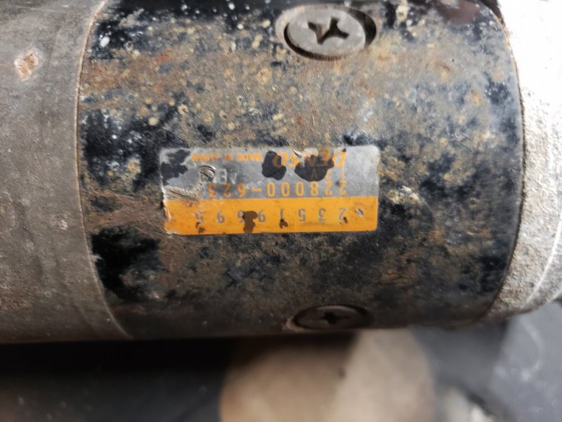

I need a starter for my engine could you take a photo of yours with any part numbers?
My engine is also from a UPS truck and has a 1999 gmc truck 11 7/8" clutch disc and pressure plate on the VM flywheel. I believe the starter supplied with the UPS package car re-power kit was different than the one used in the Hyudai Bering truck application of this engine.

Here is the starter, I ordered the Champion radiator from Summit. I haven't been able to drive the truck to test out its capabilities yet.
Thanks guys, having this part number is a huge help. I was able to find a starter. It's the same one as in used on some hyster and yale forklifts. I never would have been able to cross reference with out your help. I owe you one for sure. I have quite a bit of information about troubleshooting electrical issues and pin diagrams if you need any of that. These forums are a great community! Thanks again

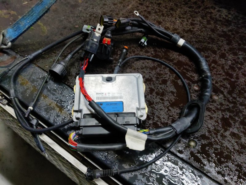

Hi,
I recently got a detroit vm 638 engine as well.
The wiring loom, ecu is all included. But nothing is connected right now. There are a lot of connectors that fit on multiple sensors.
Can you help me out with wiring?

Thanks for this info, i also would like to use the original ECU as I bought an Detroit 638 today, but i know the fuel pump can be rebuilt so its mechanical, but ECM would have my preference. How dit you wire the ECM? Is there an OBD port ?
