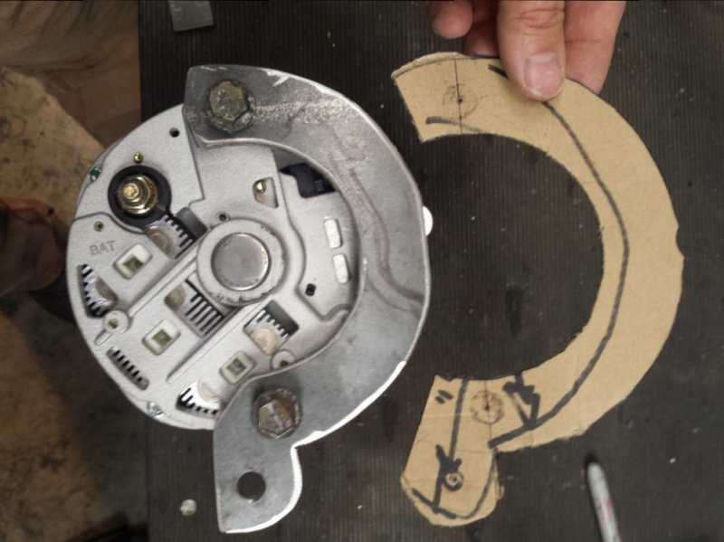

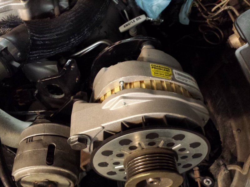

Fabricated a rear mount bracket, fitting my '95 6.5, to upgrade from the stock CS-130 to the CS-144 alternator. There are several threads about doing this; thought I'd share what I came up with as well.

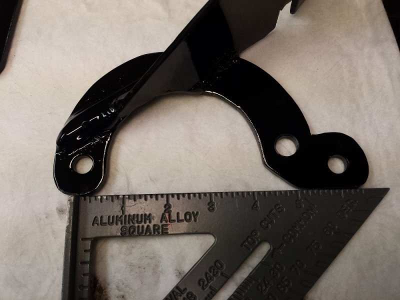

I wanted something that kept the triangulated support the OEM rear bracket for the CS-130 had. Drew up a template on cardboard, then used my portaband saw/table to cut a "C" shaped piece that mates to both available mounting bolts on the back of the CS-144 & also ties in with the bottom/front alternator mounting bolt. The C shape is made out of 1/4" hot rolled steel. Decided on the C shape so as not to restrict cooling airflow to the bridge rectifier.

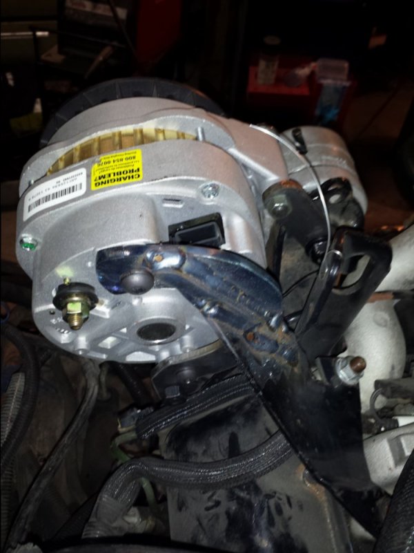

From the OEM rear bracket, I cut off the portion that's bent to vertical & mounted the back of the CS-130. The cut was made so what's left matches/fit where the back of the C shaped bracket sets, with the alternator mounted. Tacked this in place, then added a short piece of bar stock to reinforce the 90 degree joint where the C shape & remains of the OEM rear bracket meet.

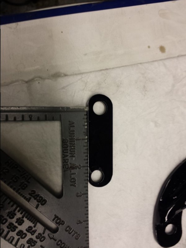

The 2nd mount is simply 1/4" x 1" bar steel with hole centers drilled a bit shorter than the OEM CS-130 strap. I'm still debating if adding a piece from the front of this upper alternator mount to the front of the belt tensioner would actually add enough useful rigidity/strength to be worth the effort? It would mount the upper alternator ear in double-shear, but the tensioner itself mounts/bolts only from its rear to the cast engine accessory bracket.

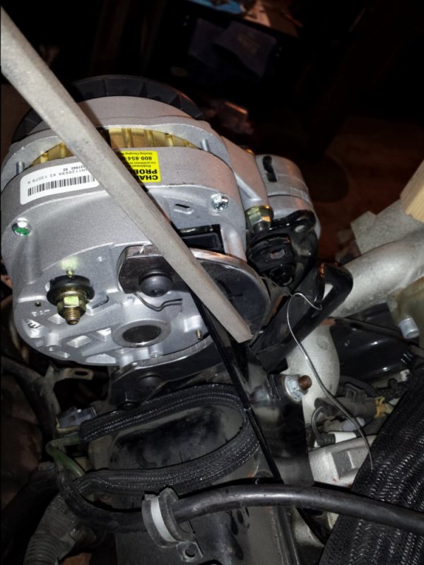

You approached the rear mount differently than I did, but with the same results. A very solid mount. I also did a single strap, like you did, for the upper mount over to the belt tensioner. I just did the one strap, and it has been in use for 3 or 4 years now with no problems.
I made the top strap mount shorter than stock. This made the alt set real close to the belt tensioner, but there is still about a quarter inch of clearance to the tensioner. This was so that the original belt fit so that I, or anybody else, could go to any auto parts store and ask for a stock belt size and have it fit.
You will love the CS-144 alt. It definitely made a difference on my pickup's charging system.

Don - in doing my research, I started with your post & pictures of cutting the original bracket & rewelding it shifted rearward. I was having difficulty picturing how to modify the face that fits to back of alternator, to use both rear alt mounting points & not impact airflow. I also noted TheFermanator's approach, years back, of using a short chunk of angle iron welded on to cut OEM bracket - because of the practical advantages of fabricating with square, 90 degree surfaces.
A "C" shape seemed to be the solution, plus I bought SWAG OffRoad's Portaband table last Fall. Gotta justify the tool purchases right :) This table expands the usefulness of a Portaband. The table & saw are a cost-effective, faster (than plasma with circle cutter attachment) way to make precise cuts to get a shape like the "C" part of my bracket.

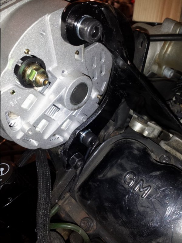

I put the AD244 on my 95 Burb. The thickness is the same as the old CS130 alternator so the back bracket can still be used.
You just need to shave off the 3 o'clock bolt because the battery cable bolt is there but the bottom bolt can still be put in there.
Then I made a short bracket in Pic 5 to hold the side.
