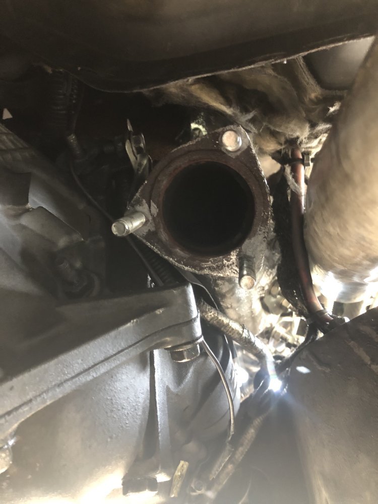

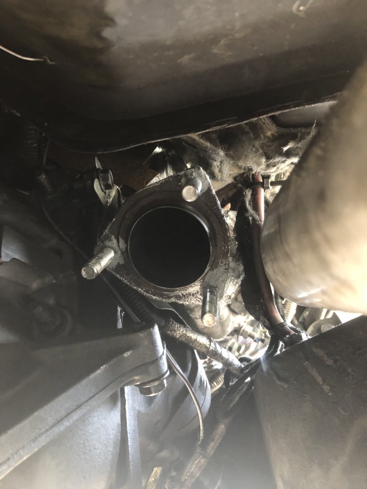

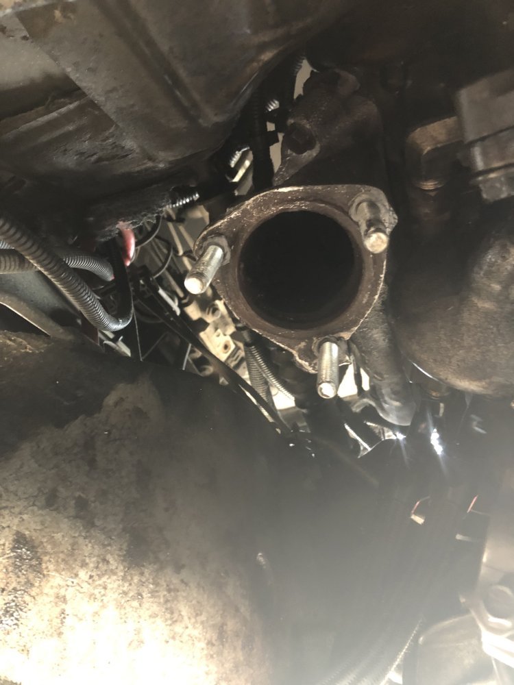

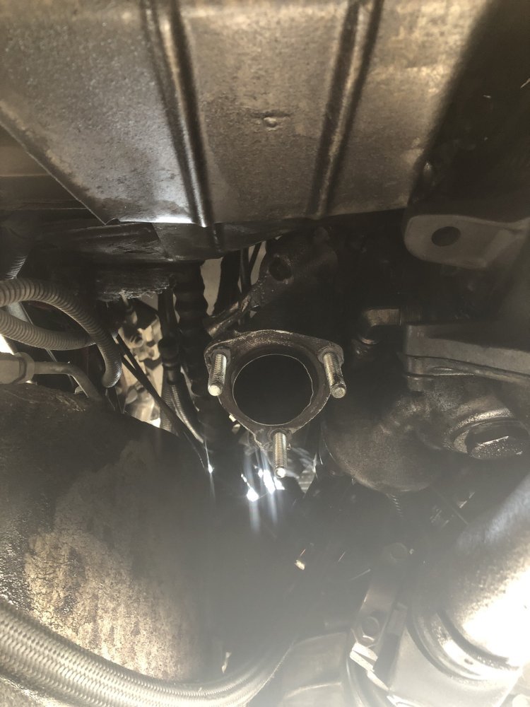

Crossover donut gasket.

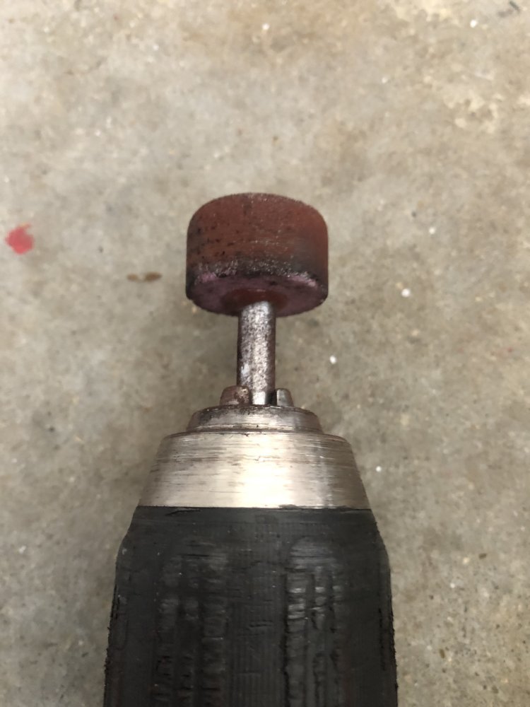

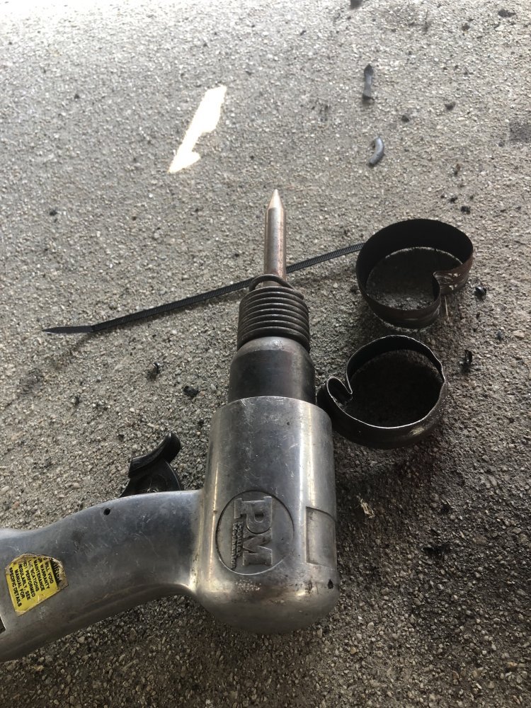

Ring left behind came out in 2 seconds. Time consuming part was using a stone in drill to clean up enough for donuts to seat. Would have been better when I had it out but it wasn’t bad in the truck.
