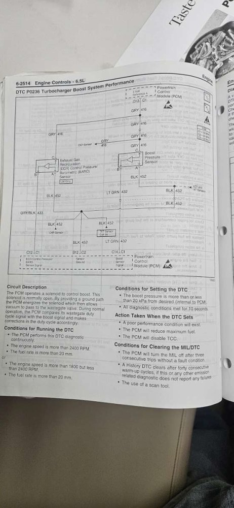

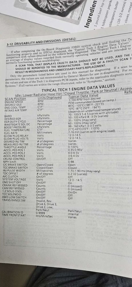

I haven't played with CTS/Optic yet, the one thing that "taunts me" is the constant high boost level 15+ psi indicated in red on the scanner with truck running at idle or with engine off & key on, no other codes present. According to text in my DS4 training manual , and troubleshooting from both the 94 OBD-1 and my 98 OBD-2 manuals saying I should be having a high boost code being displayed now, but I don't; so I'm thinking when PCM was re-flashed the high boost codes have been moved out of the way to allow for higher than stock boost limits.
If you will recall tier-1 defense from factory is open WG to control high boost, tier-2 if you can't lower boost reduce fuel rate.
Boost sensing is supposed to be a 0-5V reference from PCM biased by boost sensor for normal 0-3.5V, with high boost being set at 3.9V for 2 sec, if I get time in next day or so I'll rig a 5V volt source across the MAP sensor and read output of sensor by itself, with engine shut down it should be reading 0, like the gauge. New MAP sensor is supposed to be here Friday, I'll probably do more diagnostics as well even for education if nothing else.
Another thing that caught my eye from the manuals is TTC lock up is also impacted by this defuel/limp and I noticed it taking a very long time to shift into OD, and cruise control was disabled as well.
One more thing I did find in my training manual for DS-4 IPs & control system high IAT is defined at least in OBD-1 as >than 202F for more than 2 sec, before prompting a defuel of max fuel 20mm3 reduction for max fuel fuel, which was acceptable for factory levels of boost, but not when running above 10psi hot day 100F, ECT 215, had this happen with my ATT years ago, I lost power/acceleration, and locked in at 55mm3 max fuel rate, deep cleaned the radiator & condenser fins and have never seen it since, possibly elevated trans. temp at play as well. I think GM looked at much more than what "tuners" do/did to keep the engine as safe as it can be from self destruction, boost and fuel rate tables are just a couple pieces of the pie.

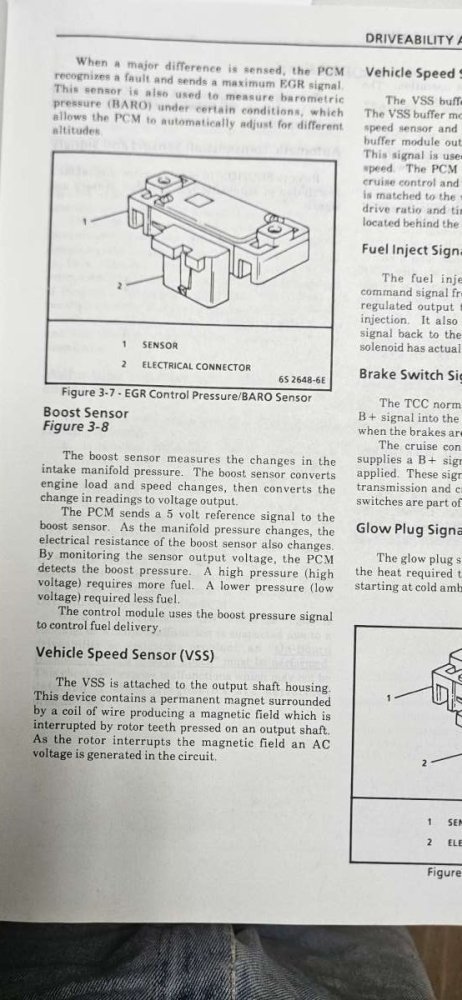

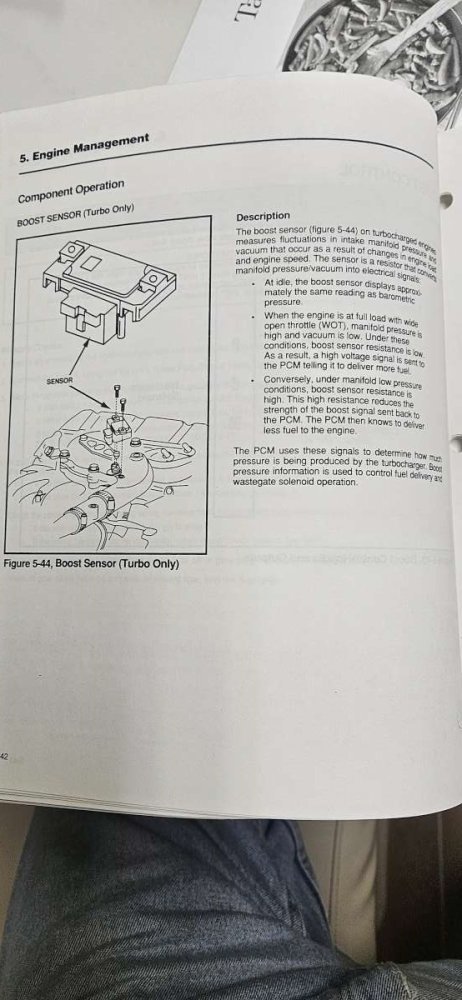

iirc the MAP and BARO sensors are the same only one reads manifold pressure the other reads atmospheric pressure. boost is calculated from the two. you can swap the two sensors and see if the bad signal reading follows on your scanner you should see both sensors data along with a calculated boost value. normally the baro should read around 14-15 PSI all the time.
Not the same baro reads vacuum, MAP reads pressure, different part #s and indexed differently in connector socket. in F engine trucks the baro reading happens via MAP sensor at start PCM stores that value and then reads boost pressure after start.
In S trucks the baro is 2nd sensor mounted on firewall under wiper motor, looks exactly like a MAP but reads baro at start, but after start, it reads system vac changes real time to modulate ERG and EGR vent valves.
Which is why you can't just plug the EGR line in OBD-2 for sure though I think, the OBD-1's S ECM is a little less smart and you can plug it.
