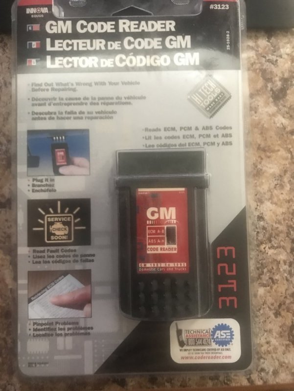

Heather, I used to work a couple of weeks a month in Marion Co. but the contract ended. Otherwise, I'd have been happy to swing by as I passed Lindale often. Still, so I'm not 'that guy' Paul talked of in James 2:16, I'll be sending you (VIA Pastor Williams) an Innova #3123 OBD-1 Code Reader. While it's just a basic boogie unit, it is new, never been used, still in original packaging and has the manual. I sold my OBD1 truck before I needed the scanner and forgot about it. So, from the Paveltolzer's to you, I sincerely hope it does you some good. I'll get it in the mail Monday.IMG_1510.JPG
