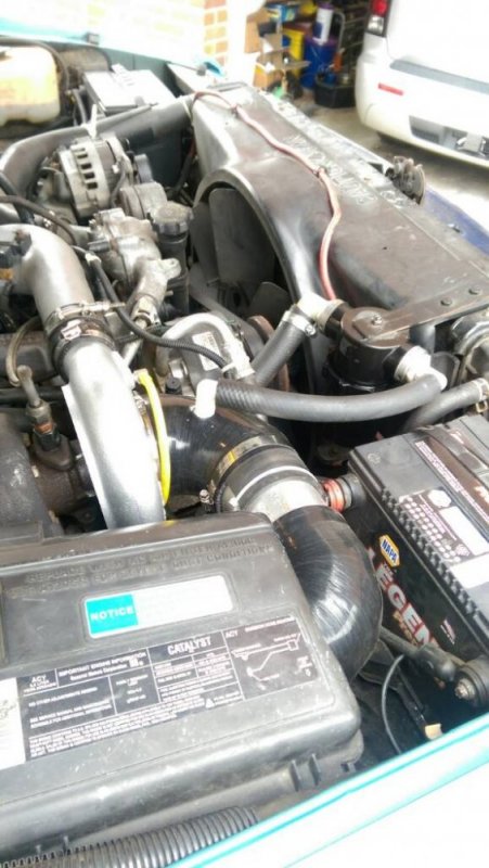

I'll have to see if I can rotate mine.
To 'rotate' mine, I had to buy a new elbow and cut a new hole
That was a somewhat sizable investment to test your hunch. Lucky it panned out for you!To 'rotate' mine, I had to buy a new elbow and cut a new hole![]()
My guess is that gravity is his friend. 12 o'clock position would tend to run any liquid back to the catch can.
I found that any tubing w/smaller ID than the factory CDR tube can increase case pressure to the point of making the rear main leak.Perhaps a vacuum/pressure gauge ran to an old oil fill cap to monitor whats really happening, hose theough the window for test driving.
Really we just dont want any pressure in the crankcase. Not sucking oil fumes is great- but if seeing any pressure (most likely during boost) is the concearn.
A guy could test multiple areas to learn highest vacuum point, but a larger hose pulling more volume less pressure evacuates more, and makes oil coalesce easier. So the highest vacuum point may not be needed. I wish someone would hurry up and invent the vacuum/ pressure inductive meter- haha.
Soooooooo true!Makes gapless rings sound better all the time.

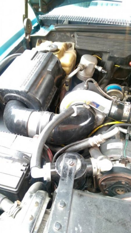

I like where you mounted the unit.I connected my setup to the intake today to see how it does. I'll look for some scrubbers to add inside the can until I find a reasonable provent.
Got it close to 12 o clock orientation
Sent from Tapatalk
Tossed in a stainless scrubber earlier and added the missing 4.5" intake clamps. Will have a few hundred miles on it this week and will update after. Thanks all.Bronze or stainless wool will do just fine for that setup......
