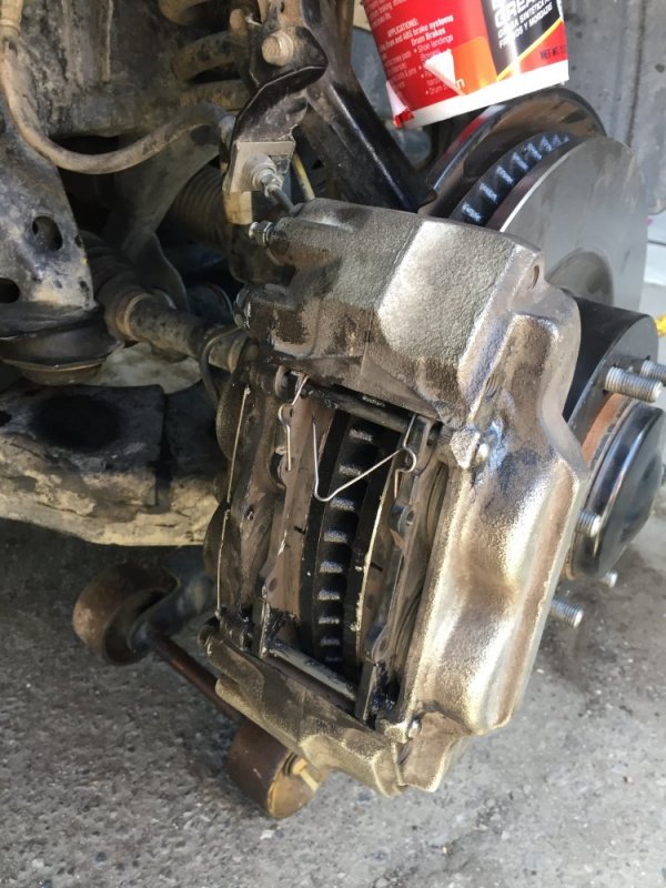

She's using the transmission to slow the vehicle coming down from Big Bear, but is still aggressive in my view. Calipers are not sticking, but I will pull them apart today and relube with silicon grease as a matter of precaution. Also make sure the bearing hub is surgically clean.

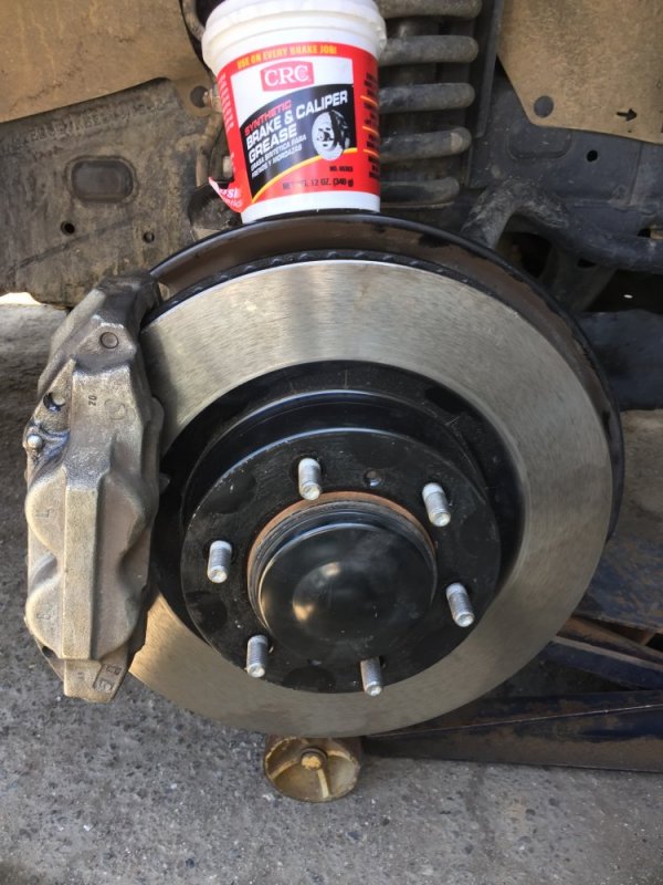

I redid them today. Also reread your article....twice.

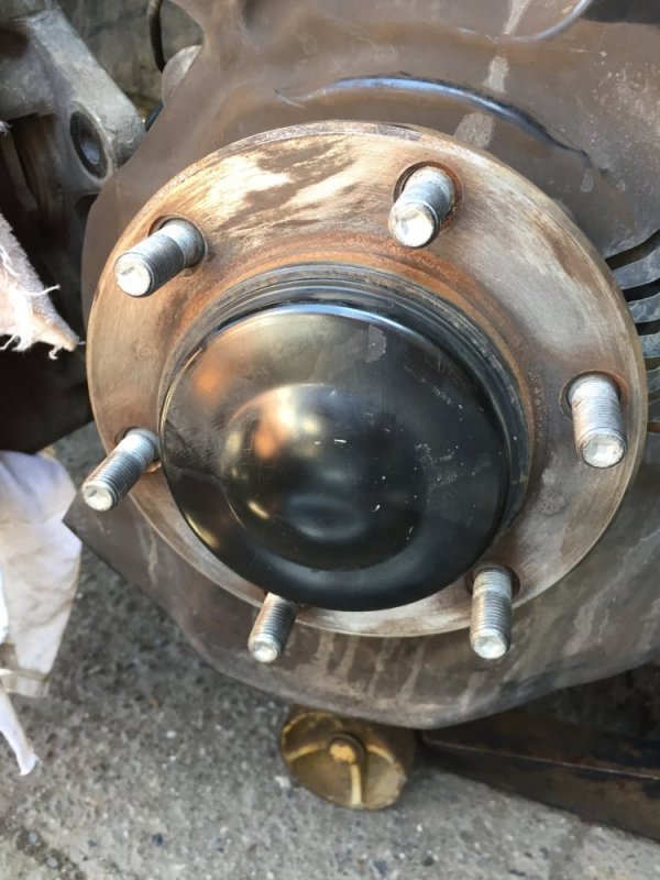

Bearing hubs had a light "film" of rust that easily came off with emery paper. We don't get rusty scale in SoCal. I bought a $20 tub of special brake parts grease and applied to every pin and bolt.
IMO the Raybestos Advanced technology are the best. I have not had problems with them in the past. This is the first time I've had problems with the Powerstop rotors. We have them on 3 other cars with no problems. Also, I change the original pads at 75K miles and they could have gone 85K to 90K which is consistent or better than what most report on Toyota forums. Her original tires went 60K miles and her second set will do the same. So those data points do not point to overly aggressive driving and braking. I just need to he to chill out a little and downshift the car coming down the mountains.
