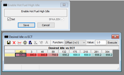

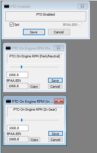

PTO settings ( I think this is the high idle switch )

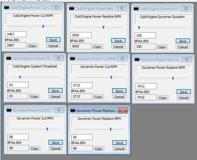

Governor settings
Idle settings

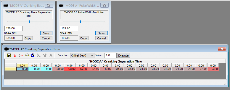

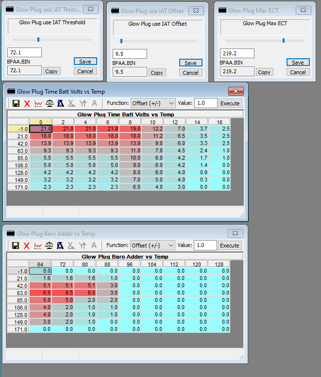

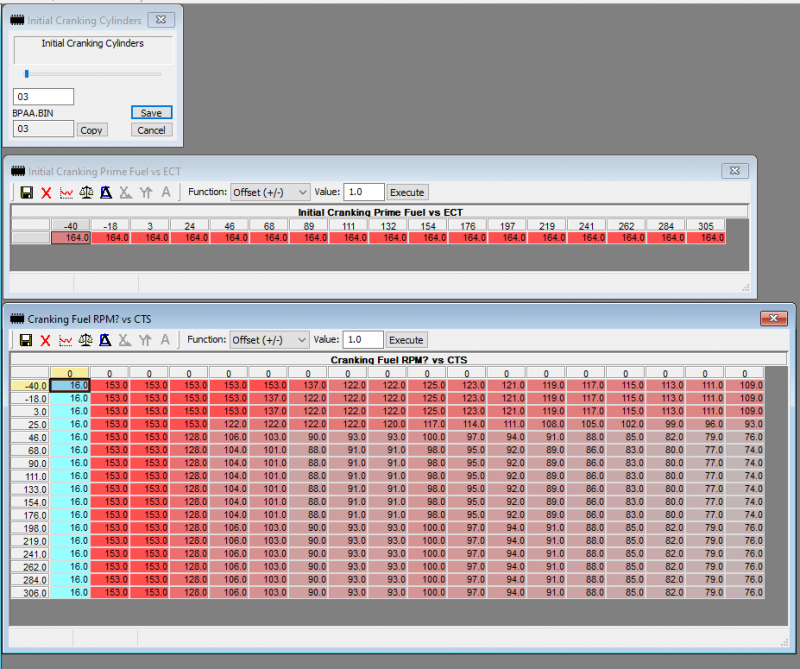

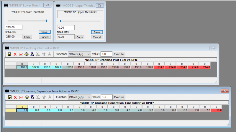

Startup settings

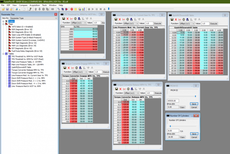

there are 80 DTC status flags in there that can be turned on and off. they were too large to do a screenshot on, but it lists all the DTC codes available each with a check box. some are set some are not. I have not played with any of them to know but I think it's simply a check box that when checked and the PCM sets that code, the SES light will turn on in the dash.
Well that sums up 99% of it. thats a lot of $hit for an obd1 system!!
Governor settings
Idle settings
Startup settings
