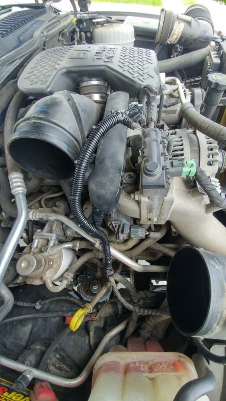

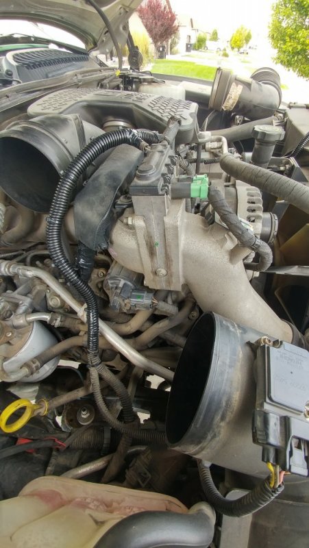

Okay so it took me an hour to instal finger stick. Tired to make it look clean and factory like. LoL! What do you guys think? Any advice? I never soldered or did this kind of electrical work before.
I ran my truck for a bit and reved it and also started it several times and no codes poped. Am I good to go or does it take a while to ensure I connected everything okay?

And the wiring looks good. Factory doesn't usually use zip-ties, just black electrical tape or that felt tape. But you should be ok. Just stay away from the ref station haha.
Nice job on the fingers stick install. Pretty much how mine looks. Just drive it. If a connection is bad you'll get a code eventually but not having one now means it's good so far. As far as the 2 flange bolts, soak the 2 with a 50/50 mix of trans fluid/acetone overnight. For me, I used a 1/4" ratchet and 12mm shallow socket with a piece of tube for a cheater bar from the driver's side while my son was on the pass side holding the socket on.

I used a snap on box end wrench and a hammer. Knock on wood they always broke right loose. And get the blocker plate installed. Without the blocker the egr valve is flowing, and the finger stick is now creating a maf error because it cannot properly correct the maf reading with the egr flowing.
Check those solder connections. You mentioned your not on top of soldering- stop by a stereo shop and flip them a $20 for 2 quick connections.

Alright everybody, I gave up! I installed twice and checked wires, colors, connections and had a 2nd pair of eyes and someone who solders a lot and he siad looked good but still no win. Codes kept popping and I tried everything so I crimped everything back to stock and no codes again after driving around for a while. NOT DOING THAT AGAIN. a lot of others and forums say it could be a bad stick.
