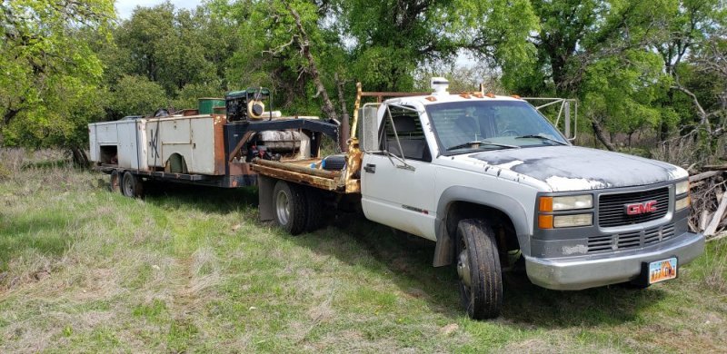

C3500HD Tow pig

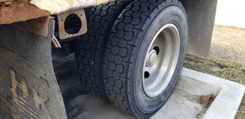

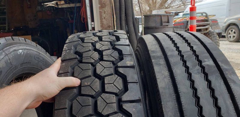

Rear tires will finally have some traction off the pavement and the truck has dropped a little over 100rpm now cruising on the highway. 245/70/19.5"s. Have a trip down to Texas next week to drop off some of my stuff at the property, which will require some dirt road driving. Old tires on the right.
Those tires should get some grip....👌
They better, the old tires had issues with just a hint of a dirt road or snow haha. My property down in Texas only has dirt road access right now so the tires were a necessity. Bought some cheap offroad recovery boards as well in case I need them there.

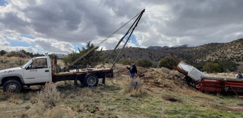

Made a mistake when mounting the base for the poles, it sits too high for the winch to be able to raise/lower the gin poles on it's own. So have to run a strap from the top of the poles to something solid (used the trailer as a anchor) in order to raise and safely lower the poles.
Once they are up though, it works as expected. Need to make a mount for the front of the bed (has mounts around the hitch rails but no further forward) since under a load you can see the front of the bed move up from the winch. Ended up lifting the bed/chassis/axle fully off the ground no problem.
You were running steers on the rear instead of drives? No wonder why you had no traction off pavement.
Yea it had steer tires all around when I bought it (different sizes but all steers). The new rear tires provide enough traction for what amount of dirt this truck is expected to see.

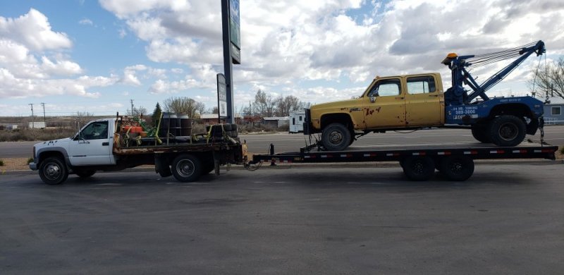

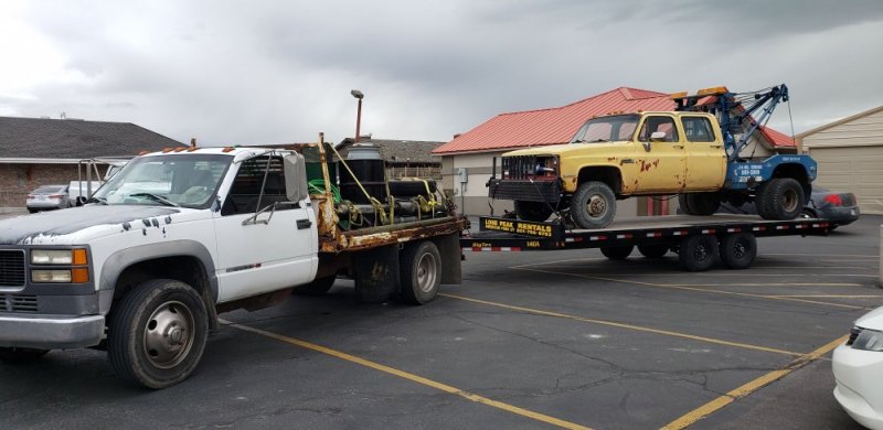

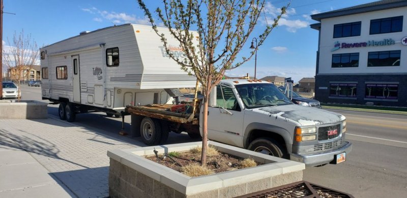

In other news, items for trip 2 and 3 are falling into place now. 20ft flatbed rental trailer is reserved for late next week/weekend, which is how the 82 crew cab is getting transported along with the last of the garage type stuff. Final trip will be with the in house stuff, and a toy hauler needed to be found for my temporary living arrangements down at the lake. Been looking for a fairly cheap one in both Texas and Utah, found this one in Utah for cheap enough that it's worth transporting it. That will be moved on the 3rd trip later this month. Actually in pretty good condition inside.
Second load of stuff moved down to Texas. Rented the trailer which reminded me part of why I prefer gooseneck/5th wheels. Fuel economy is currently 8-10mpg loaded heavy, 11-12mpg with just the trailer, 19mpg empty. All cruising at 60mph, 2400rpm. Improving that is a future goal.
The HD handles itself well at 60mph with these weights (24k last trip, estimate 22-25k with the wrecker). If the truck can be modified to handle the same way at 70mph I'll be happy with it. Figure hx35, intake, exhaust, tune, and regear to around 4.10's should take care of it.
