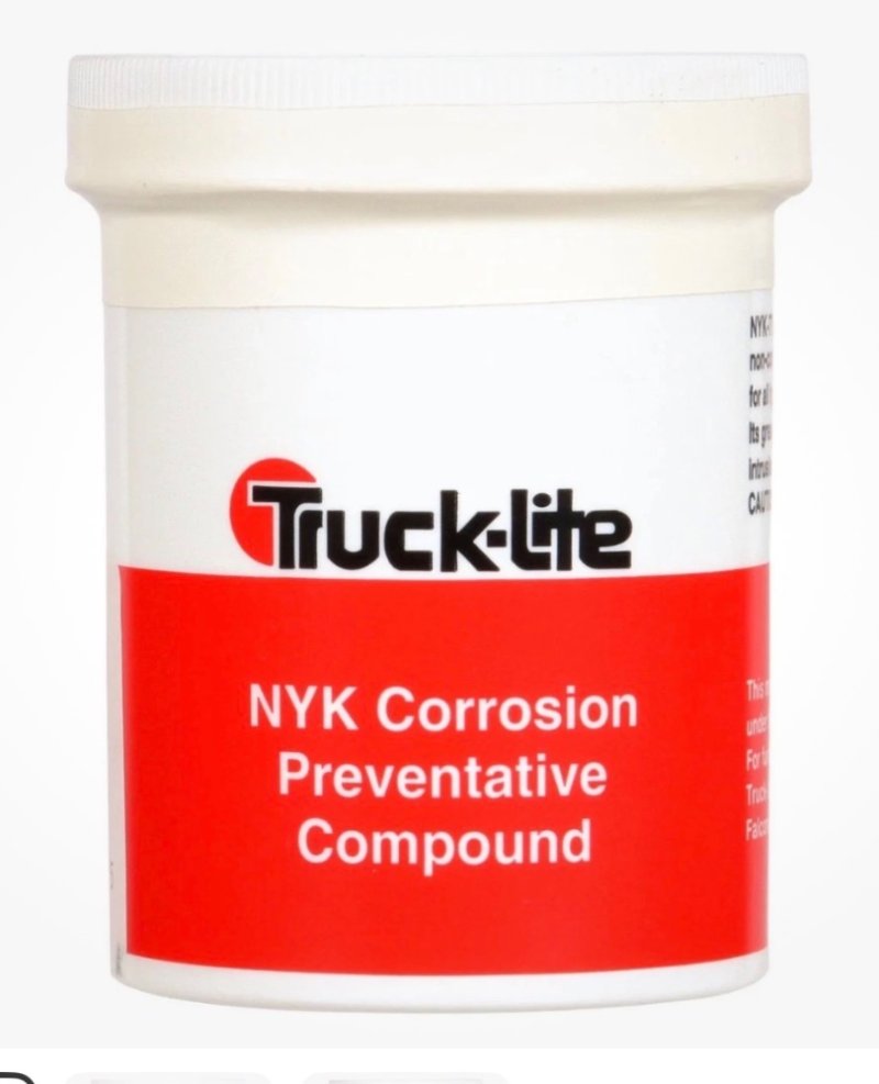

That is simply dielectric grease. Shouldn't be used on the actual connection just used to coat it to prevent water from getting in. In other words make the connection and then apply it on the outside to seal it. Dielectric grease is nonconductive and can interfere with the actual connection
Guess I’ll use that no more. Maybe on bulb bases or some such.
