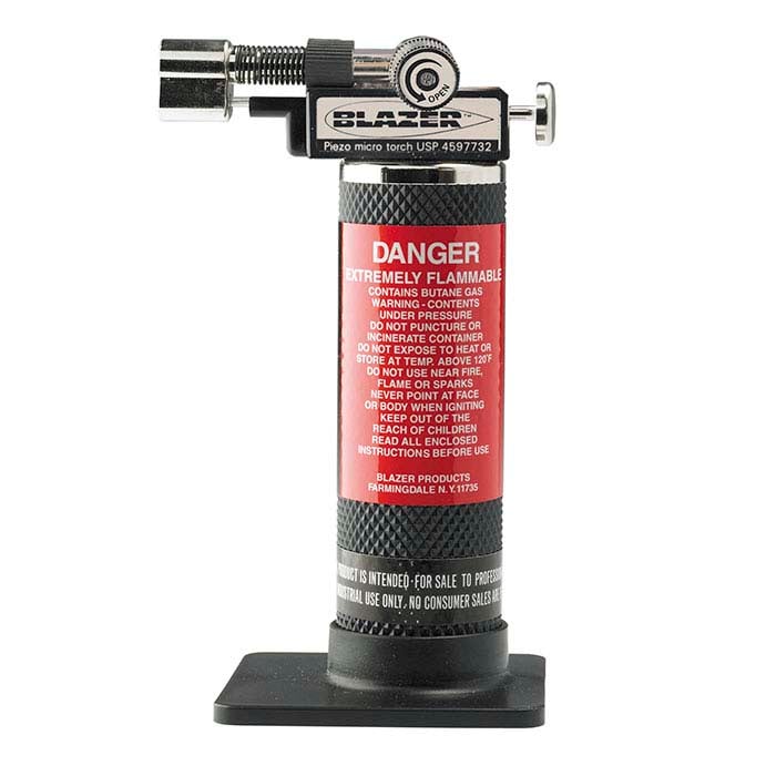

I once had a froze in bolt and did not have a full size torch. Is what I did have was one of those little hand held blaze king ( i think was the brand name ) torches. That little torch heated the surrounding steel enough to get the steel to smoking, I held the torch around the seized bolt a while longer and it came right out then.

I have one of those too. They too work well. I was just surprised that the little Blazer torch would heat that much steel to allow that seized in bolt to release.
