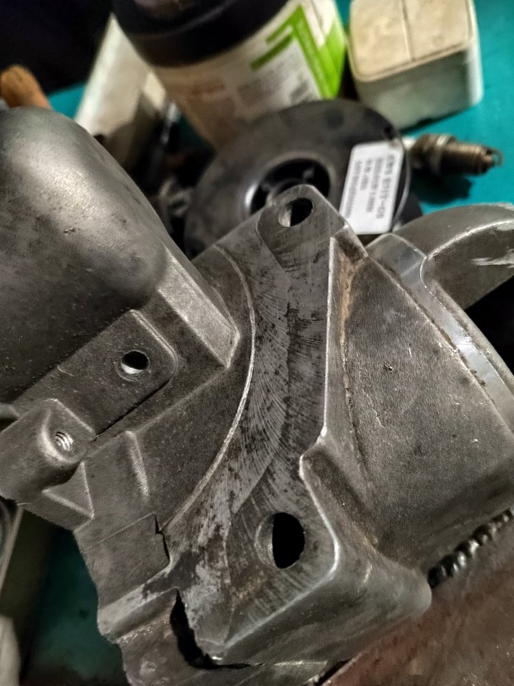

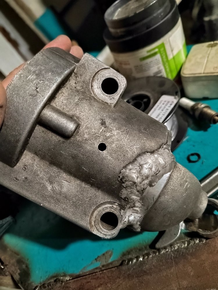

Is your starter one of the factory style ones from the auto parts stores by chance? could be that when they put it together or if it's a chineesium copy the holes might have been drilled slightly too large. Powermaster is the way to go hands down but if your not wanting that yet, measure the holes and OD of the starter bolts. might be able to use a piece of copper or stainless tubing to take up the slack. might have to use a cut off wheel on a drimmel to split the tubing just to get the sizing right, but it's only to center the bolt. once it's torqued down along with the bracket in place you should be good.
pay close attention to the bracket making sure it's not bent. mine was bent when I pulled it. I actually took a scrap piece of angle iron longer than the bracket so that the end continued down to almost the level of the oil pan. drilled the holes for the bolts. when mounted to the block the end of the angle iron just barley rested on the block near the oil pan giving more strength. I have some pics somewhere I can share if you want them.
