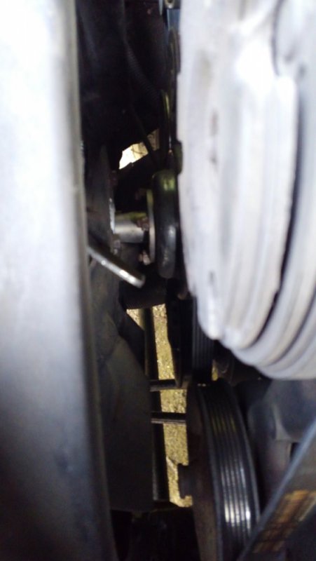

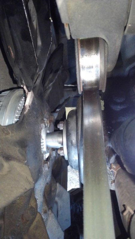

And Actually mine is the four bolts. (Clutch fan) I'm just hoping that 99 water pump will fit when It gets here tomorrow.
