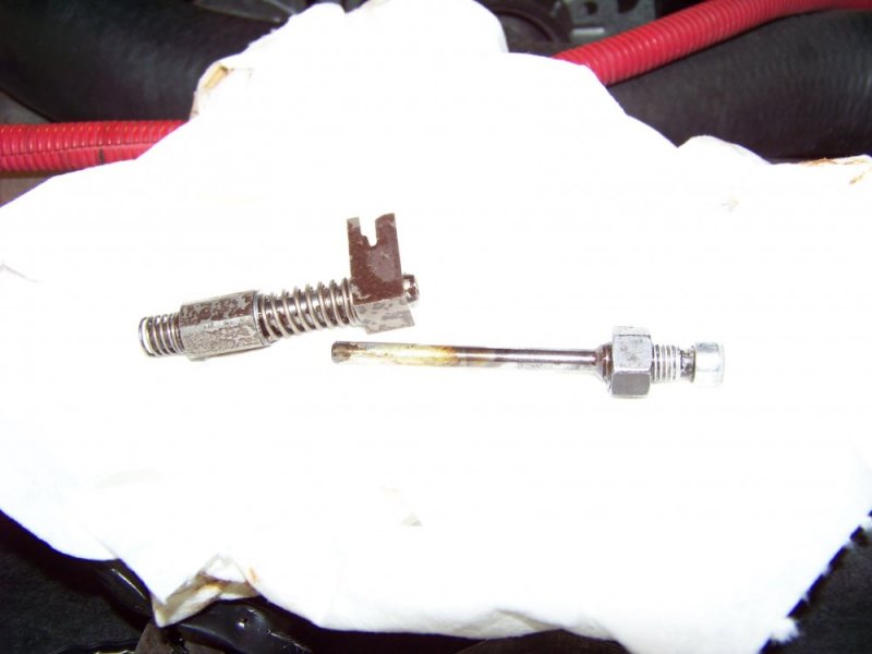

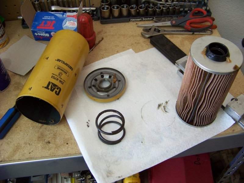

Ran across the photos of my 1993 IP that was ruined by the bad Biodiesel. Same fuel after a CAT water Separator filter did NOT ruin the Injection system on the 1995.
This is what corrosive and wet from bug infection fuel does to an injection pump.
The CAT 256-8753 fuel/water separator is what saved the injection system on the 1995. The fuel was literally a different color, clearer, on the clean side of it. I can never find this number when I need it.
