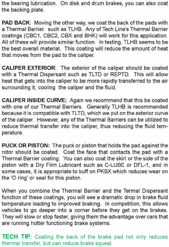

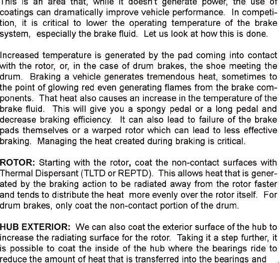

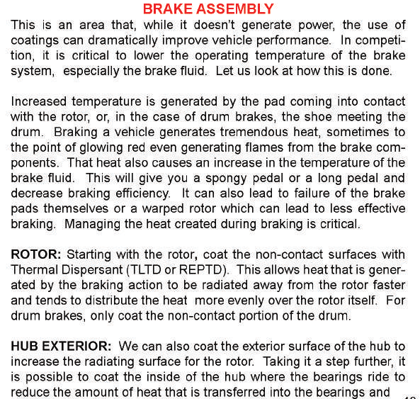

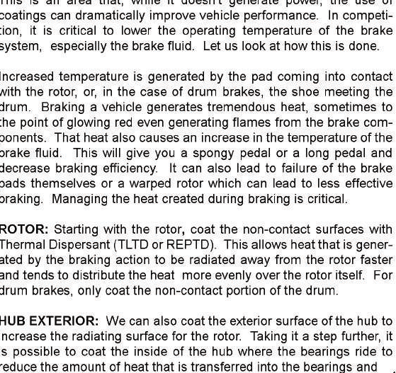

Twisted Steel Performance Anything worth doing is worth overdoing. Messages 4,038 Reaction score 7,766 Location Pauline, SC Apr 12, 2018 #1 Attachments upload_2018-4-12_17-6-24.png 114.7 KB · Views: 6 upload_2018-4-12_17-7-32.png 167.4 KB · Views: 6 upload_2018-4-12_17-8-42.png 117.3 KB · Views: 6 upload_2018-4-12_17-9-22.png 168.7 KB · Views: 6
