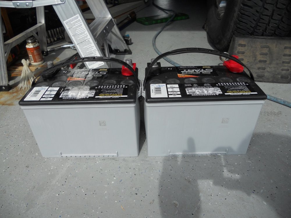

Well it's been 1 yr on the new battery's, while what few times I have used the truck it had always fired right up, battery's were always hot..
Now it's been siting 3 months now and I went to crank it today and battery's were flat dead, and nothing was left on. I have a good digital charger so I hooked it up and let it charge for a few hours, the charger will let you know what % charged and the voltage in the batteries and will maintain when fully charged.
After a few hours I noticed the maintain light was on, checked and the volt was 6 .... WTF...
I disconnected the cables and tried each again thinking something may be shorted, well the same thing, fancy charger said they were fully charged and showed 6v...
Thinking my charger was bad I tried another charger, same thing would not charge past 6v...
Anyone know what is going on ???
Battery plus is going to check them and replace if needed but I can't see 2 batteries doing this at the same time...
What gives ???????
ECM and radio memory could have drained them in 3 months. Brake light switch intermittent coming on as well as horn or dome lights intermittent due to hot/cold temp swings. Overdischarge and not charged = sulfated to death and kills any lead acid battery. One battery going bad will take the other one out in via overdischarged and sulfate to death.
At 6V you have 3 shorted cells. Quit Messing With Them!!! Use the warranty. Batteries can be dangerous and explode. Ones with known problems even more likely: Not. Good. Odds.
