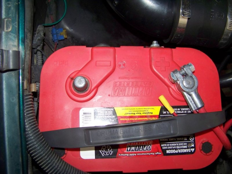

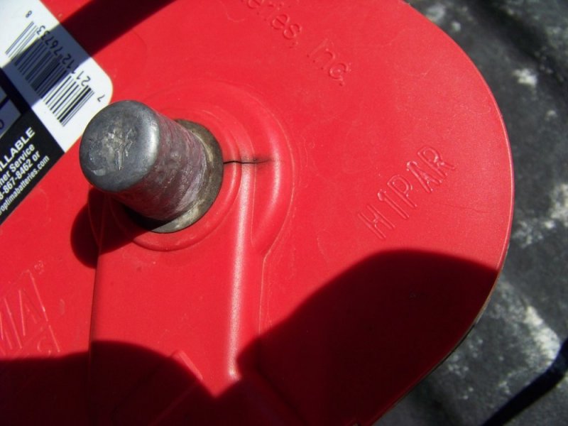

Here are some pictures of Optima's starting to leak at the posts from cracks - the post that cracked was not used as the burb this was from has GM side terminals. I have had several Optima's fail like this in the past 6 years. I returned for refund all I could and gave away the last two Optima's I had with receipts from the last "exchange" of them.
Even in light duty gas engine DD SUV I had this cracking. Jonson Controls absolutely cheapened up the original design that made Optima's Legend. Part of this bean counter "cheap" is changes to the ingredients or leaving some out, and moving the manufacturing to Mexico. I watched the Aurora, Colorado version of the battery become Legend in the early 90's as they were the only thing that would last on air cooled diesel light plants. The vibration of those noisy beasts would ruin other batteries quick. Optima Batteries started outlasting the engines that ran every night 365 on a construction project in Colorado.

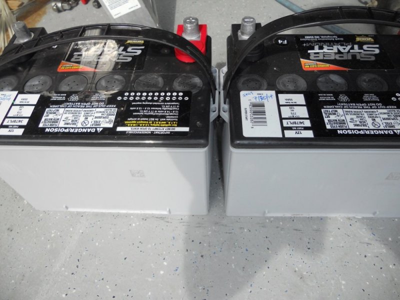

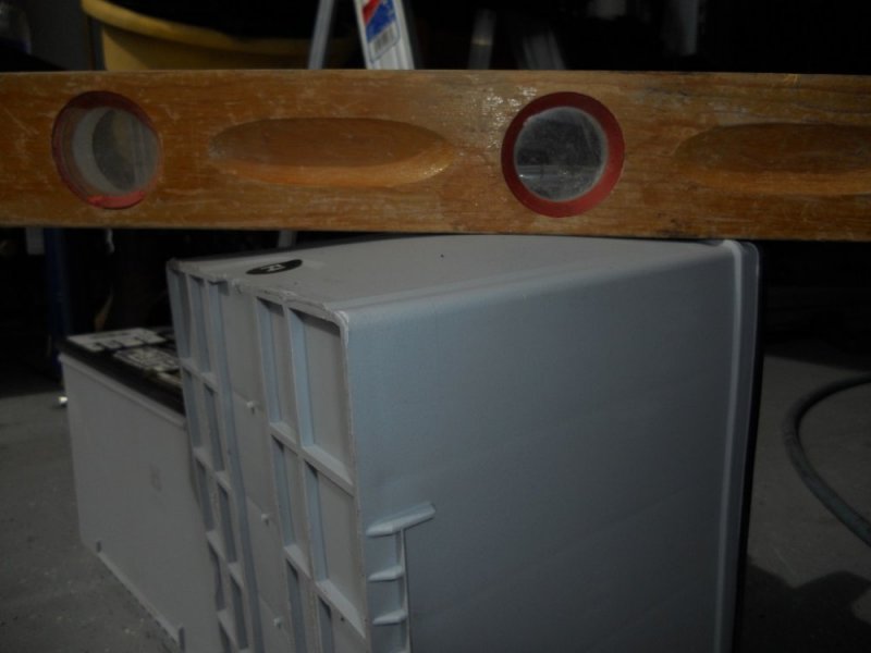

Other AGM's don't even pass Consumer Reports heat tests like the relabeled Deka AGM's I tried. Maybe one day I will try some Odyssey's. Meanwhile I exchange the flooded cell stuff every year and am lucky to make it into year two on the diesels. Cooler gas engine DD's make it longer.
As neither brand of AGM could take the heat they have been kicked out of my kitchen.

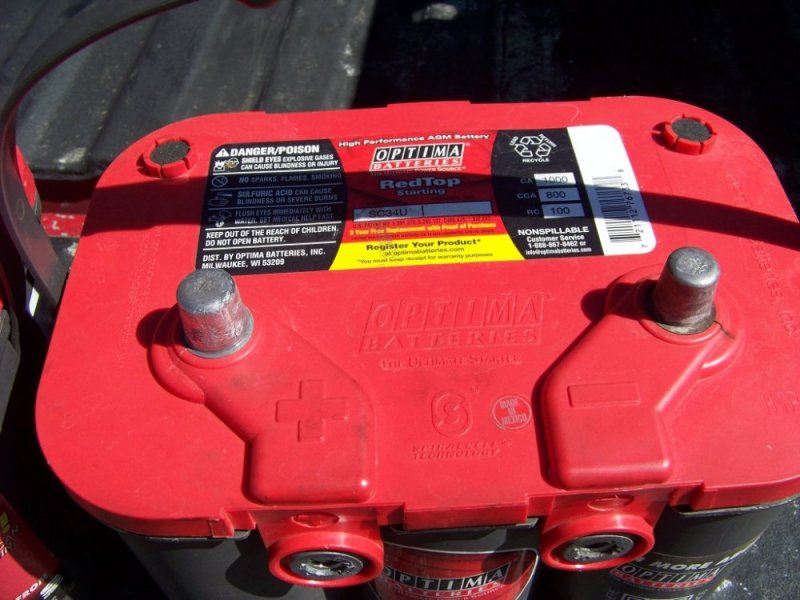

Here is one of the last two I gave away. Infrequently used in a 1993 gas 454 truck. Shorted cell and the 25 year old battery charger is one that would recover Optimas (from bad battery piles in the 90's) as it doesn't have the low voltage do not charge safety in it. Hint: this is why new chargers have the safety cut off in them.

I have seen one of them crack at the top post like yours did, but it was on a 5ish year old battery and we emailed a picture to customer service and told them this battery mounted at an angle with the posts facing downward. They sent a credit for $100, and the rest was on my friend. I thought that was fair on a battery out of warranty.
