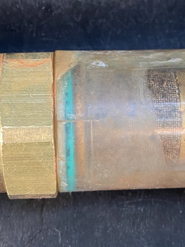

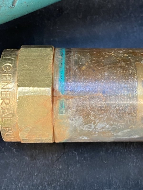

Yesterday I had to go into the office, so I decided to drive the truck in so I could show it to a buddy of mine. While I was showing him under the hood I noticed coolant leaking from the heater hose filter. Heck of a way to impress a guy….

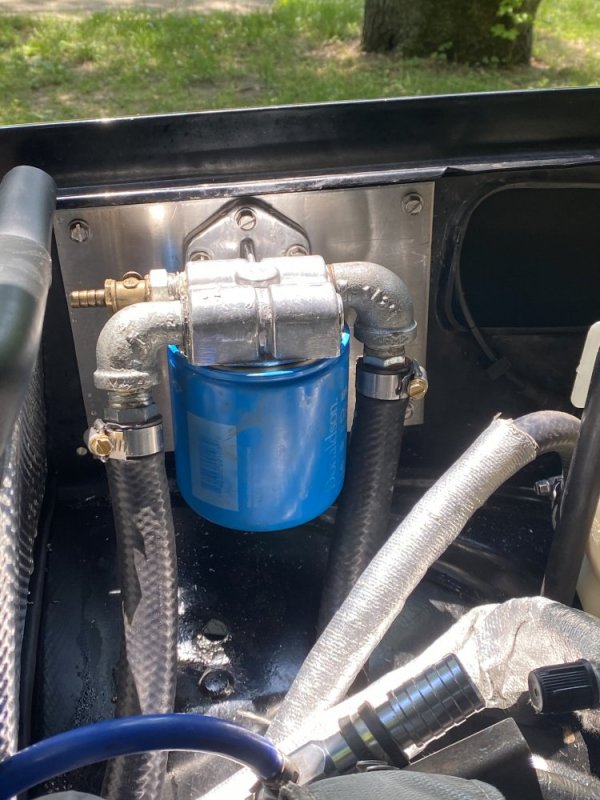

So I had to remove that and then install the screw-on coolant filter I had using stuff I had laying around. I installed a bleed valve on the outlet of the filter head so I can purge air since it’s so high and so I can crack it open and see if it’s clogged or not. I still plan on installing a flow meter, but this will get me by for a while. The old filter didn’t have as much junk in it this last time, so hopefully a lot of the larger junk in the system has been removed already.
The old filter had 2 cracks in the plastic body. This is weird since the plastic isn’t structural….the brass spine is. I guess it just couldn’t handle the environment. Good thing it didn’t let go at a critical moment.
