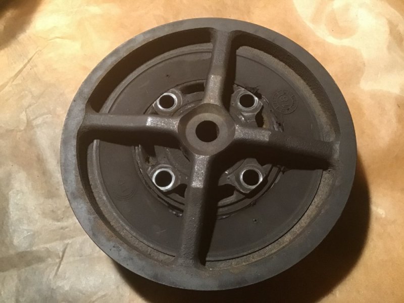

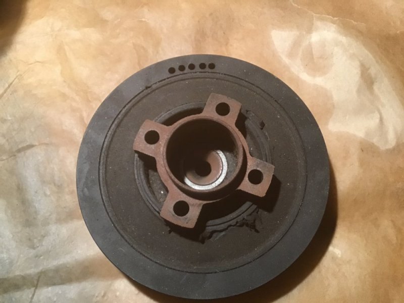

Amazingly odd to loose a harmonic balancer with that short of life-
The factory balancer is best replaced at 100,000 mile intervals using only AC Delco. Or buy a fluidampr snd it will outlive any engine. There is no manual saying replace it that often that is just learned from experience btw.

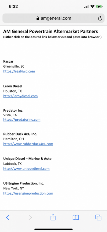

There is only 6 companies-authorized buyers of new engines from GEP the maker of the optimizer. Two of them have ties in this forum, see pic, so find out who the company you are getting your new one from is using and ask for the paperwork to show your engine is new not a rebuild. Get pictures of the Julian date code and the endless roads castings before they install.

Fortunately I have the old harmonic balancer here I can take a photo of and show you.
and I still have the time… it is gonna stuff up holiday plans I have had made over 12 months ago but damn for the investment I was prepared to make I want get it right..image.jpgimage.jpg
Btw… I did a search for 6.5 L Optimizer for sale and the first thing that comes up on eBay is a U.S company called Bostic in North Carolina I think.. can anyone verify them as legit?
Also the company I have been dealing with is one of 2 x companies here in Australia that promote the Optimizer they are called Brunswick Diesel in Western Australia. If anyone can confirm they are one of the six distributors I would be grateful.
Good help is hard to find, I appreciate your advice Thankyou!
I just sent an email to AM General for they’re advice on who to deal with in regards to a brand new engine, if anyone here can offer advice on a company in the U.S that is the real deal please let me know.
I do not want to blow my dough a second time round.

For future reference:
Predator on the list is questionable- work seems ok but price is crazy and not always honest. Hummers primarily.
Kascar also hummer primary, good company.
Rubber Duck another hummer good company.
US engine production- HELL NO! They have multiple business names they operate under and with. One of which is Bostic mentioned above. Do not trust a thing they say or do.
