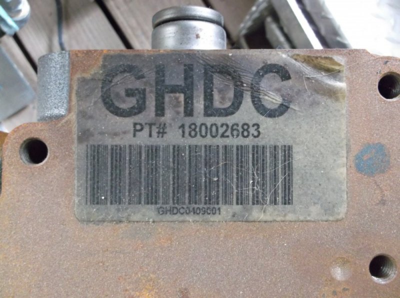

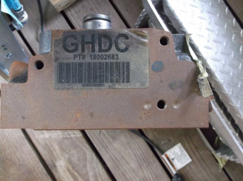

Seeking info on P400 heads please, are there any identification markings stamped into the heads to indicate their genuine P400 build heads.

P400 does have identifying marks on them. It is a paint code they use and some machine marks.
In pics below you see a part #. Also the two splotches of paint to the right and the machined dots one on each side of the bolt hole. This is how AMG IDs the P400 head amongst their heads.
They also have a casting # but the same casting is used in the Optimizer. Only difference being the P400 has hardened valve seats vs induction hardened.
View attachment 47920 View attachment 47921
many thanks for your reply Leroy very helpful I will check my p400 engine in the morning, also can you tell me if the thermostat housing comes only as a dual unit on the p400 as standard, Im also seeking supply of two TPS units for the mechanical pumps, I have 2 p400,s will post some pics of our terrain tamers etc there very much a custom build dedicated to extreme 4WD in our deserts etc
