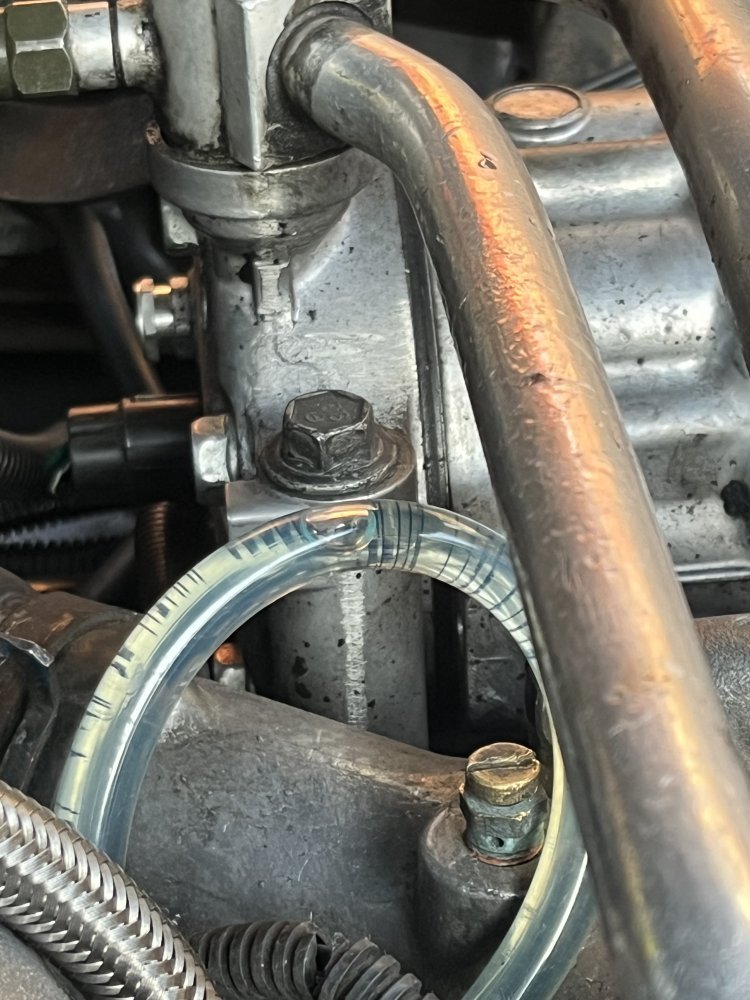

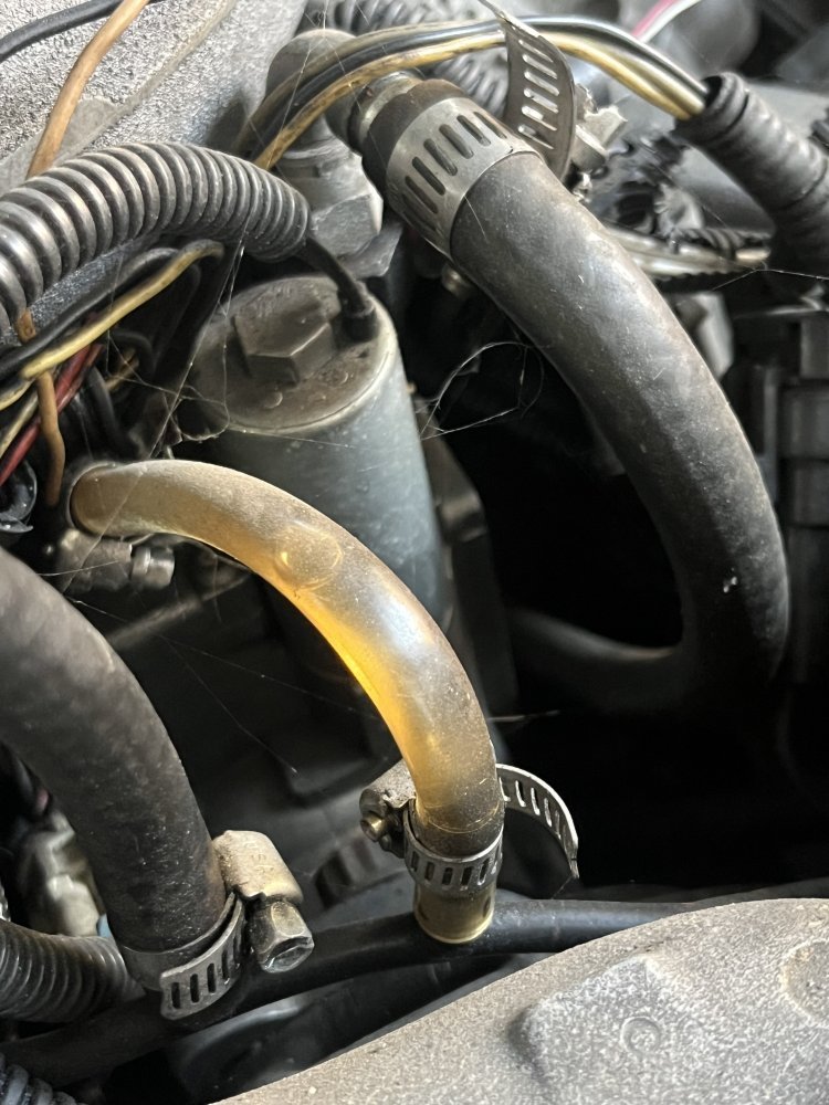

Yes I am. Problem is the ip is supposed to be the high point other than the filter bleed. And if the filter is sealed properly- the ip return could drain out either way.
I’m wondering about easier ways to determine which half. Cut the clear line in half, connect with double barb fitting. Then when it is shut iff for the night, pinch both sides, disconnect them from each other and leave both ends capped.
See which side drains. If both do- there is a problem both ways.
