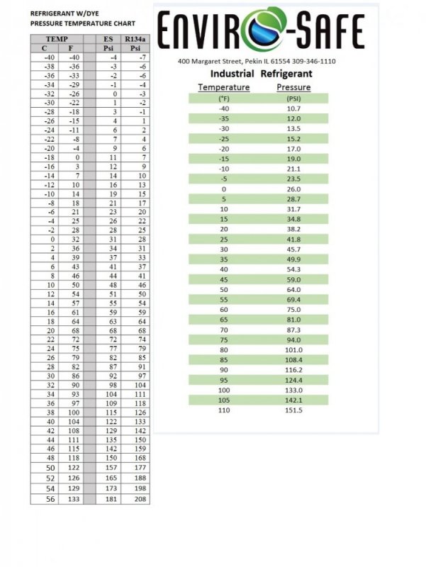

You can use your stock R12 low pressure switch with the HC based refrigerants. Most R134 low pressure switches cycle off around 22 psi, if you look at that chart, 22 psi of r134 is equal to 26 for ES, and R12 low pressure switches happen to cycle off around 25-28 psi. It is best though with ES and a flooded evac to not use a low pressure switch, but instead switch to a thermal cycling switch where it has a temp probe in the evaporator core and uses a temp switch to cycle the system by actual evap temp instead of low pressure.

The thermal switch must be installed into the actual evap core, it cannot go into the line. The problem you run into wth the HC based refrigerants is they do not actually fully flood the evap. When charged fully they will still boil off some in the evap due to GM's flooded evap design. So you cannot fully go by low pressure. The 2nd best option would be to use an early style low pressure switch you can manually adjust it to cycle off at the higher pressure.@THEFERMANATOR , do you know of a thermal switch that will go where the low pressure switch is in the dryer , is that where you are suggesting using one?
