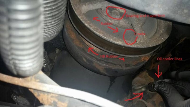

Replace them with SS braid ones from Leroy. The OEM ones will leak in no time and are failure prone, IMO not worth buying.
Well I'm strapped on cash I just dumped new tires on itReplace them with SS braid ones from Leroy. The OEM ones will leak in no time and are failure prone, IMO not worth buying.
Or I'll just have to borrow some money to get them done for now also is there any good wright ups on doing them. The video on his website kinda confuses me because the engine isn't in a vehicle.Just put it on the list of more important parts to replace. When they fail, engine failure will result. Ask me how I know.
Well that's bad news. I'm guessing I should do it all at once. do I need to remove the radiator or is there enough room once the fan is taken out of the way. Also the oil cooler lines do I need to remove the oil filter and filter housing to change them or can I get in there with good tools.Your crankshaft pulley rubber is done. I can't tell on the Harmonic Balancer that is behind it. The HB oil seal looks like it may be leaking. Oil cooler lines are leaking at the crimp due to bad GM design. Suggest aftermarket replacement from Leroy, but, replace ASAP!
No never took the front clip off i got the truck then it went straight to the body guy to fix the rust. Yea I don't feel like pulling a motor did that on my powerstroke wasn't fun. Well hopefully I can get in there without taking the oil filter off or the oil cooler housing.Usually I just pull the engine to change these.(Well I have the engine out for other reasons and do these at the same time.)
I have changed them with the fan etc. in place.
Manifold can stay on... Oil filter has to come off at a minimum. It's 1 huge bolt to get the leak prone adapter out of the way so make sure you have a new oring kit for it. Do not re-use an oil filter as the gasket will loosen it up on re-use and leak.
To get the lines off they have spring clips that can be pried out with a small screwdriver. Then the lines pop out. Putting OEM lines on put the lines in then put the clips back in as the clips go on easier with the lines in.
Have you removed the oil coolers and cleaned the condenser debris out from behind the oil coolers?
Remote mount oil filter? I was just going to keep the same oil adapter on there I don't have money to change anything else or to take it to a rad shop to be cleaned I'm assuming there just going to use a power washer the same as I will. Never changer a front main seal only ever changed a rear main I don't know if it's the same as changing the rear.The leak prone adapter is the 90 oil filter adapter - wait maybe you are doing the remote mount oil filter so this may be removed.
Do the front oil seal with the HB.
If you have the front clip off you may as well take the radiator to a shop and have it rodded out to get the dirt out of the "outside" fins. Any restriction is a cooling problem on these. You can use scrubbing bubbles on a couple sawhorses to hose the outside fins off if it doesn't need a rad shop..
OK I'm doing everything tomorrow so the oil filter relocation is that something I can get from napa or advance auto or another parts store? I would like to do everything while I'm already dirty and under there so if not I'll just get the oil filter adapter o rings and seal it up along with the front main o ring.Power washers just bend fins. Use compressed air.
And then lay radiator flat and use scrubbing bubbles to clean the bugs out and rinse with a garden hose - no nozzle or pressure. Again bent fins are difficult to open back up.
The powerbond one is the same price as the napa and dorman and the one powerbond is $417.99 so maybe its the same as a dorman one? http://www.oreillyauto.com/site/c/search/Harmonic Balancer/02316/C0332.oap?model=K2500 Pickup 4WD&vi=1052659&year=1995&make=Chevrolet
I think I'll just go with ac delco.
I already got everything and the OEM harmonic was only 60 or 70 on rock.I'll just replace all the O rings on the oil filter adapter and front seal. I don't mind changing the filter I'll just take the front drive off every time it made it hell of allot easier when mine was off to change the oil filter.
If you're going to spend $417 on an OEM style damper, go up another 8 bucks and get a fluidampr instead: http://leroydiesel.com/product-category/engine-products/
It will outlast the truck, but why spend almost as much for something you may have to replace again further down the road?
The oil Collier lines can be done more cheaply than the kits available if you're strapped. Buy the cooler adapter fittings (I think Leroy still offers just fittings) then head to a hydraulic shop and have a couple lines made. The hydraulic shop can also provide the 90 degree block fittings. Someone here can give you the size. There are two different sizes depending on which block you have.
I still run the stock oil filter adapter. No leaks and no issues other than being a pita come oil change time. I have the parts to relocate the filter, but I'm out of room in the engine bay to do it.![]()
