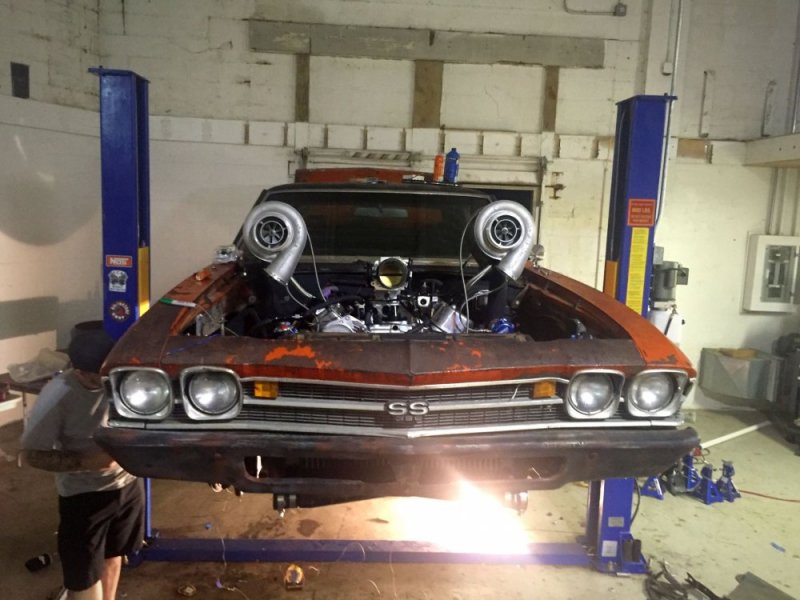

Yeah.... If they are going to do that, couldn't they at least get them level, even, etc. I can go for 2 turbos floating in the middle of the windshield, but not with 1 twisted and 1 of them 2" higher and 1 1/2" farther to the outside.
Cut them a little slack Will.....I'm sure they were just thrown off by their toilets and turbos spinning the wrong way.

I don't know, I've been kind of inspired lately by the way the Aussies utilized space for their Drag Week '69 Chevelle...View attachment 48576
They should touch up the intakes:
