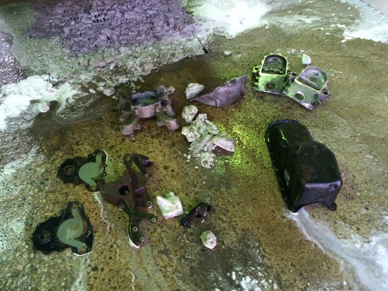

Pressure washing parts tonight. It's really fun when it's so cold that your degreaser freezes! Yes that's ice, not soap foam...image.jpg
Just the thought of pressure washing in that kind of cold sends a chill up my spine! :D So why do you have both timing covers, and plate out there? Trying to decide which ones your going to use?

Yeah it's no fun for sure!! I wanted to be sure the cleaner stuff off the Optimizer was for sure the same as the 97 stuff. Plus since I'll be hanging on to my extra stuff I figured it would be better to store clean parts rather greasy parts.

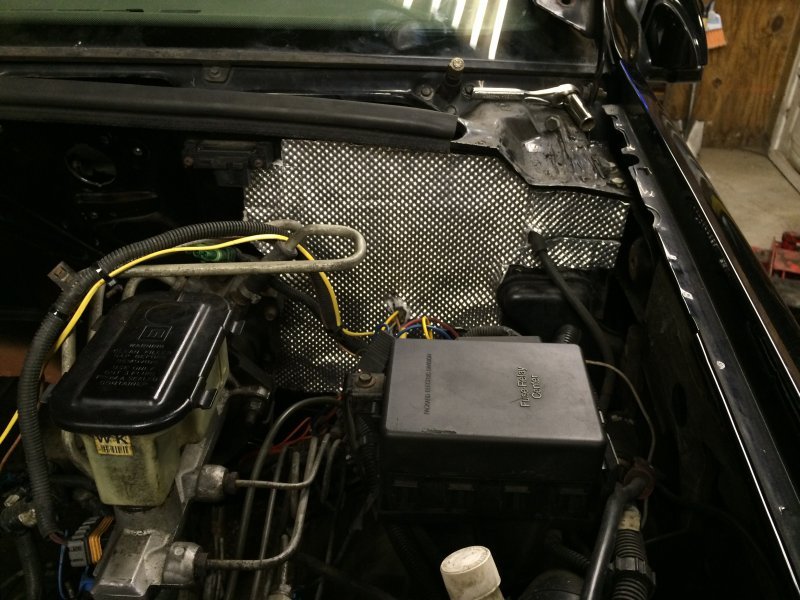

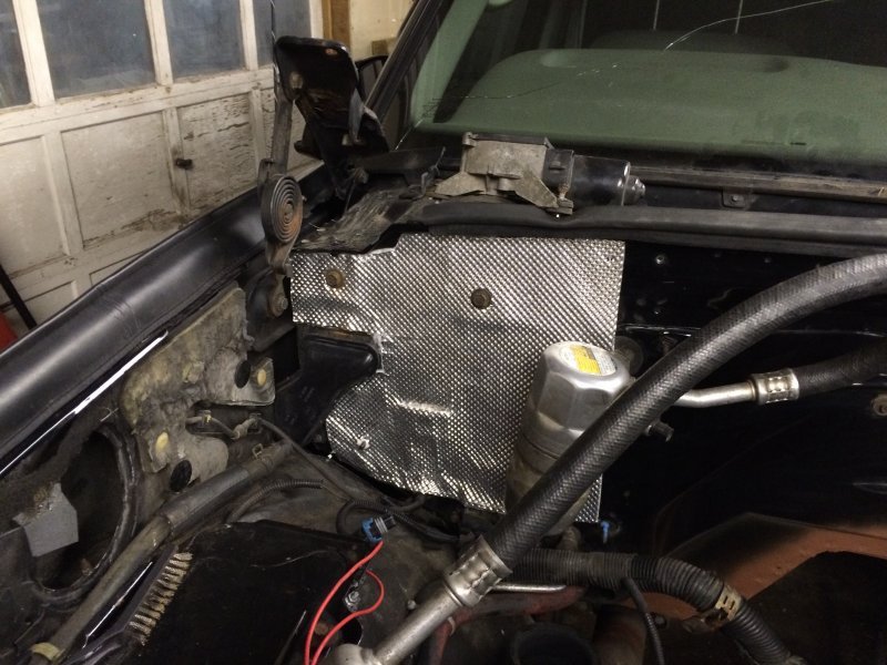

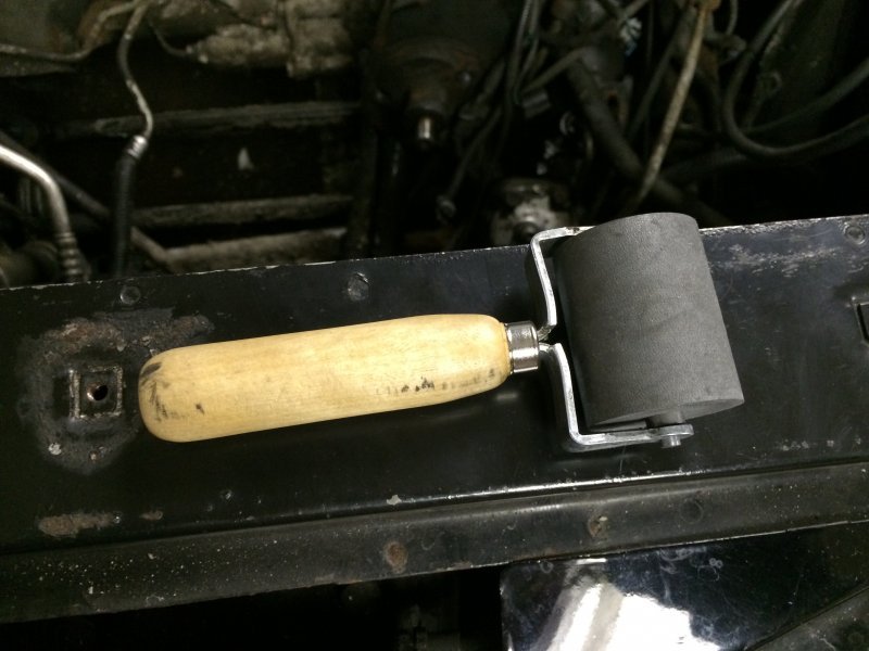

Yes it forms very well. Fellow Traveler has it on his S&B air box in his cold air induction thread and he did a really nice job forming it around that. I searched DEI Tunnel Shield on YouTube last week and found a video of a guy installing it on the floor of his truck. You can see how formable it is in that thread. I also bought a Dynamat roller to really lay it on the firewall.

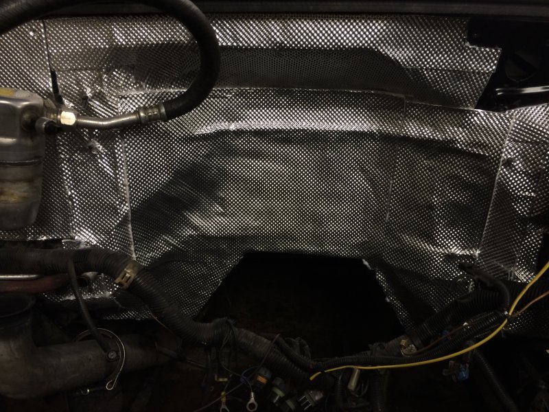

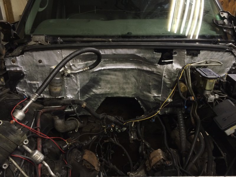

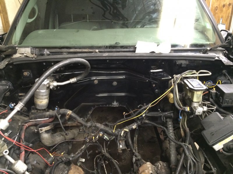

I got the Tunnel Shield finished on the firewall. I just need to tape all the seams with foil tape. It didn't go too badly overall. I think I have about 3 hours into installing the Tunnel Shield and of course I got faster as I went. One thing that made it faster was not worrying about making perfect butt joints and letting it overlap. I also ended up putting a second layer in the middle of the firewall to cover seams and also to hopefully get additional sound deadening there.

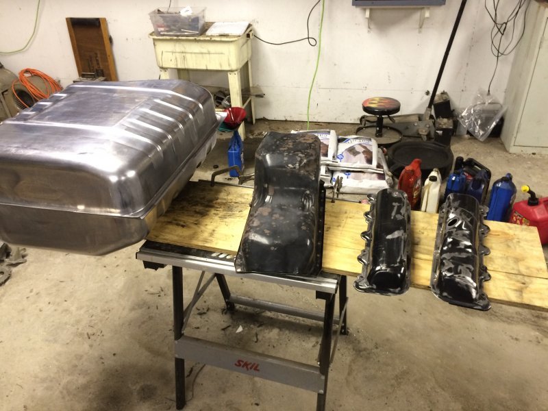

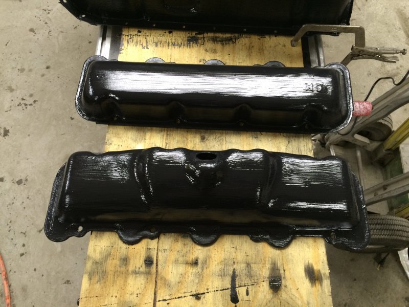

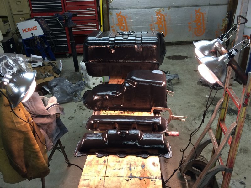

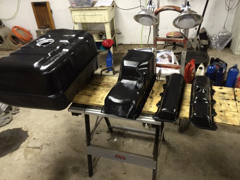

Something else I did today was paint the valve covers and oil pan with sound deadening paint. Who knows if it will do anything but I had the paint so why not? Hopefully it keeps the tin pieces from being speakers of sorts for the internal noises. Unfortunately I had to brush the paint on so the valve covers won't be nice and smooth but if it does knock the sound down then it's fine. Also since I'm painting it cast iron gray I don't think it will look that bad. I also painted the new gas tank with the same paint since it is supposed to be really good at fighting rust. I have heat lamps on them now to hopefully help them cure, but I'm also hoping I can throw them in an oven at work to get them cured fully before top coating. I don't think I'll be painting the engine until next weekend. I wanted to paint the firewall with this paint but didn't think I could get it to cure well enough before I installed the Tunnel Shield. The paint is really interesting...it's really thick, thicker than paint, but not as thick as tar. You can see the spheres floating in it kind of like metallic paint. image.jpgimage.jpg image.jpgimage.jpg image.jpgimage.jpg image.jpg image.jpg
