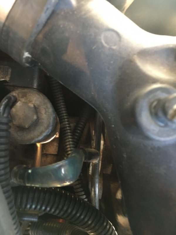

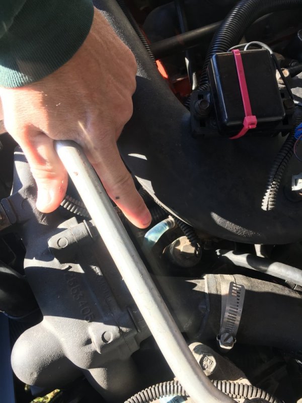

Do You have a clear hose hooked to the fuel return, if not, install one and check to see if there is air being pulled into the system.
Looks like you have to pull the upper intake to put a clear hose on ?
I can only find yellow tinted Tygon hose suitable for fuel.
Hardware stores sell clear. Home Depot,lowes, ace, truevalue. And normally you can get right to it. Inbetween the ip and thermostat housing.
The yellow tinted hose should be okay, long as You can see through it.
Dont need to pull the intake, install the hose clamp on the IP with the hex to the left rear so it is readily tightened from the left side of the enine. I installed the forwards clamp, on the return pipe, with the clamps gear mechanism to the rear of engine and the hex pointing forwards and to the right. I could then get on it with the 1/4" drive, a mid length extension and the flex/wobbly attachment.
