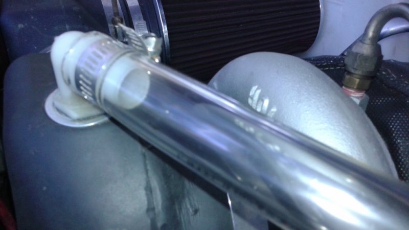

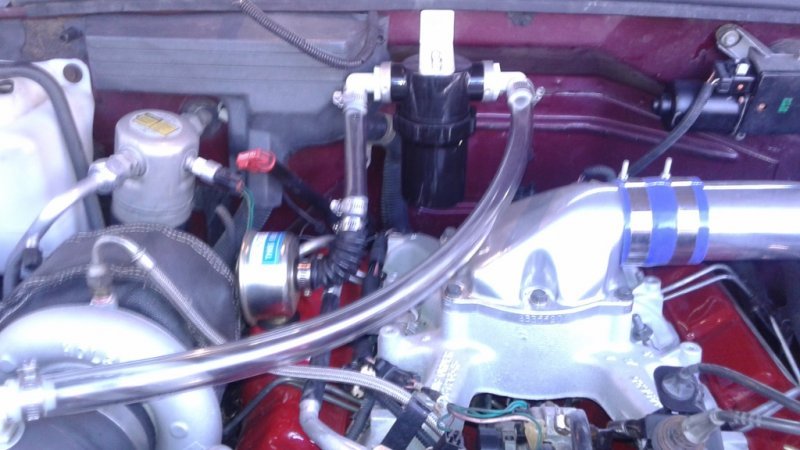

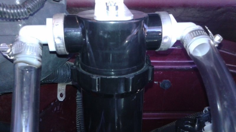

I thought I'd post an update on the performance of the oil catch so far. I've put a little over 600 miles on it since it was installed, and 200 miles of that was pulling the load in the picture below (a 97 Suburban on my car hauler). You can see in the pics below how the inlet of the filter is oily, and the outlet is not. It seems to be doing a great job of pulling the oil out of the air. I pulled the cup off of it, and while there wasn't any measurable amount of oil in the bottom, the filter was oily. So far it seems to be an effective setup, I will continue to update as I get more miles on it. Thanks
Matt
