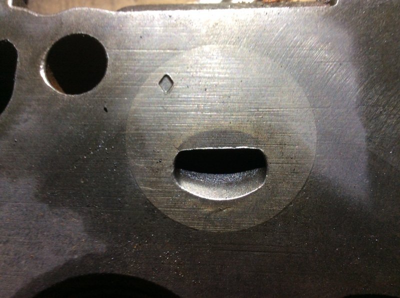

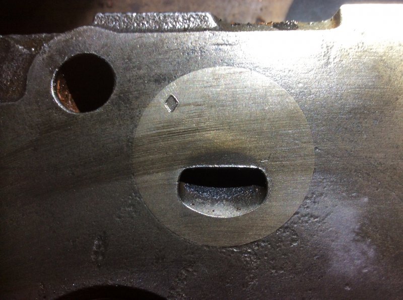

Hard to see but looks like the 1st pic has a crack going up to diamond beyond the ring.
2nd pic I see 2 cracks? 1 at 3:00 going to the left and top right corner going out at 2:00. I can not see it goin beyond ring.

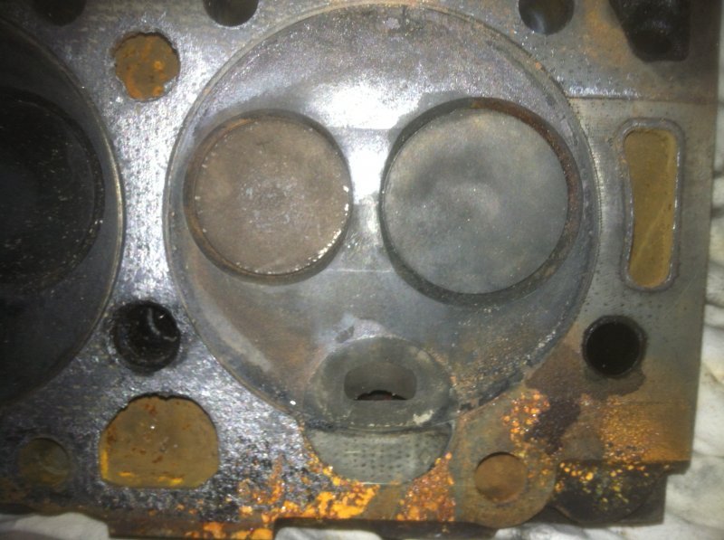

I use a brass drift(fat headed punch) to knock out the cup through the injector port.
image.jpg This pic shows the fire ring area. Any cracks in the precups that are inside the carbon covered area would be ok to re use. If the crack goes into the grey area where there is no carbon you need to discard the precup.

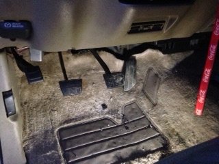

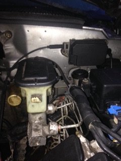

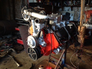

Mounted pedals, hydro brake, and clutch master pictures tommorow, putting t stamp pre cups in low mileage heads question? Any sealant needed to reinsert? Parts for motor in mail from rock auto, re ring kit and ac deco balancers thanks guys for rock auto code saved 23$ all adds up thinking of moose jr injection pump next and maybe a turbo from leroy
Runs like top! five speed in, need to have rear driveline made but got all wiring and gauges and almost there, one more day and I should be driving, lots of little bugs to still work out have to wire up transfer case went with manual so wireing different from auto 4x4, wiring always slows me down:( not my cup of tea but soon yes soon
