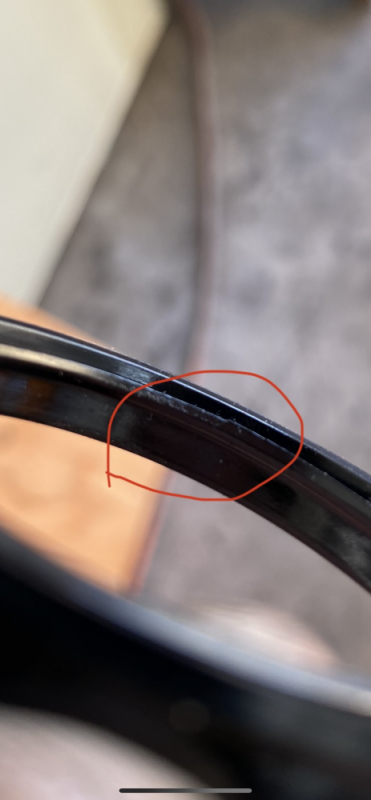

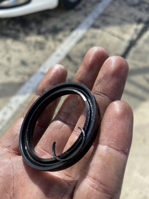

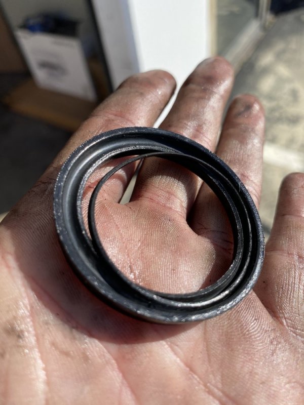

Pulled it apart, this is the main cylinder/bore seal. I think this is the culprit. I put a new one back in, but I blew out the seal I just replaced. Nailed it. New booster it is.

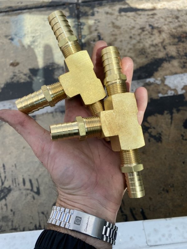

Lots of good news. Got brakes working, spent $100 on brass fittings for my heater lines, and had my exhaust finished. Still loud, but not like a dump truck.

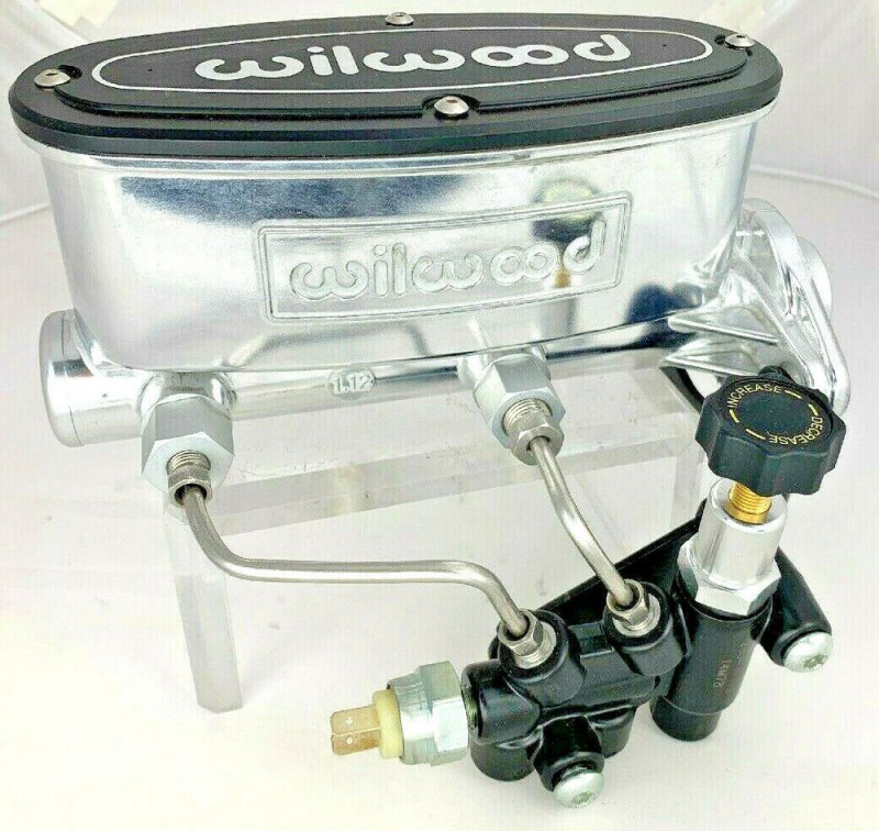

Wilwood MC
Wilwood prop valve
All new brake hardlines
Basically new soft lines at knuckles
All new Ford D60 brake assembly parts
They’ve been addressing the brakes, and it’s still locking up, but only the fronts. The prop valve is set at approx 60F/40R. The tech was saying that he doesn’t think it’s the booster because if it was the booster, all of the brakes would eventually lock up, I agree with that assessment. Ideas?
