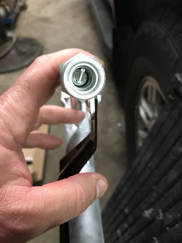

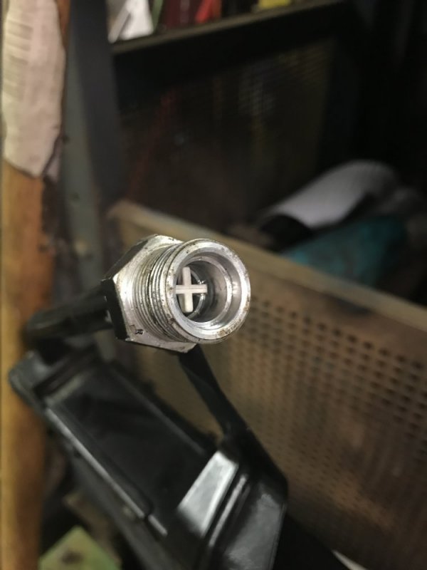

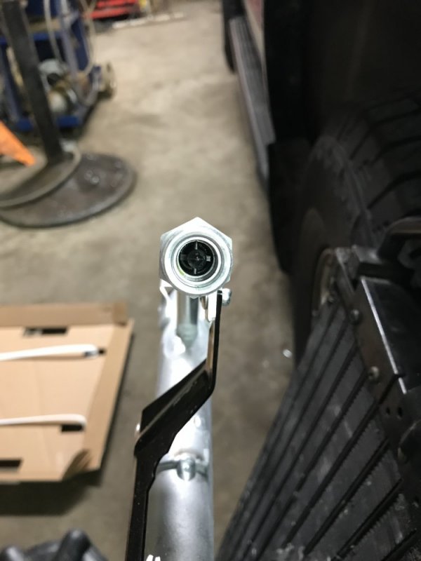

This is how far I can get the original tube to fit in the new condenser.
No problem slipping it into the old condenser.

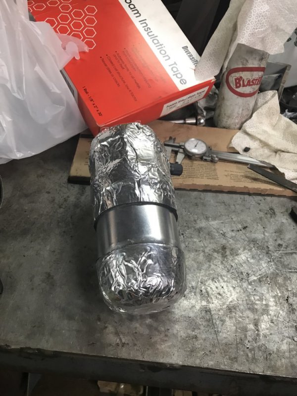

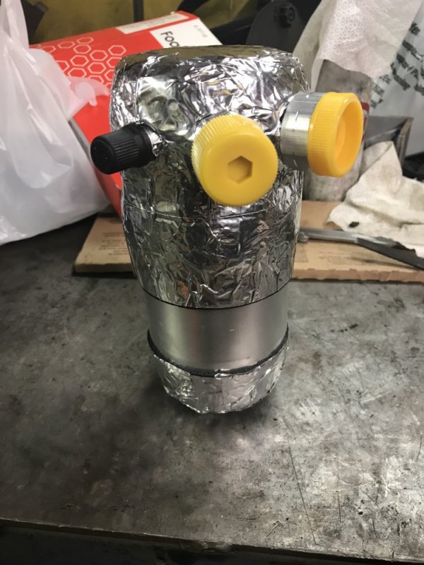

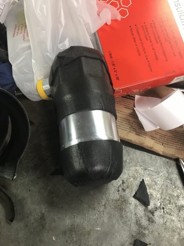

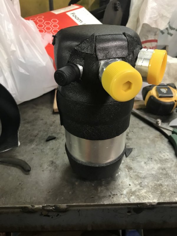

Since I can’t make progress on the condenser until the new parts come in I decided to prep the accumulator for installation.
First I wrapped it in 1/8” foam insulation tape everywhere but where the clamp will be.
6BD71759-6B46-4BB7-877C-41D926F1D543.jpeg 4502C04D-A1F7-4341-9DDB-36D553FB1E03.jpeg
Then I wrapped the foam with aluminum duct tape.
9B69372E-881E-485B-9A77-1D3CF1462C80.jpeg CC09506E-E7D6-44CB-AAD8-31384BD249DA.jpeg
Hopefully this keeps a little of the turbo heat out of the AC system.

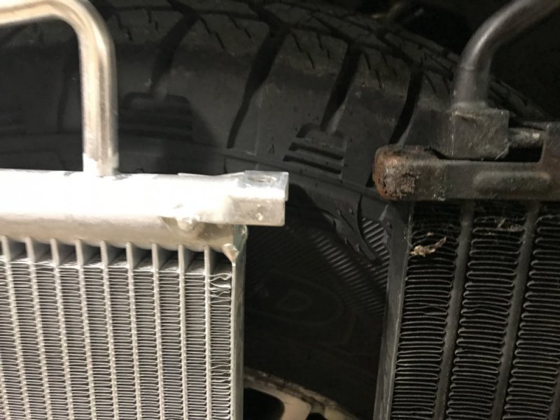

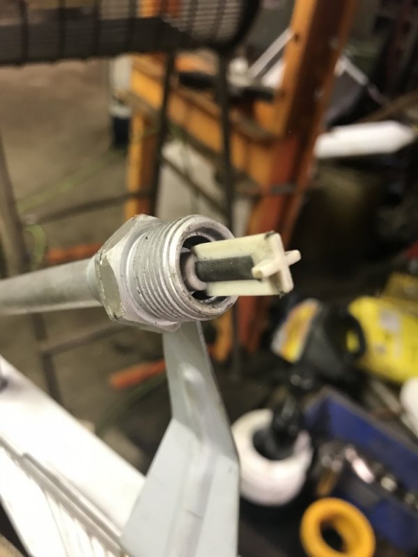

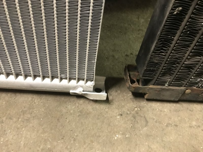

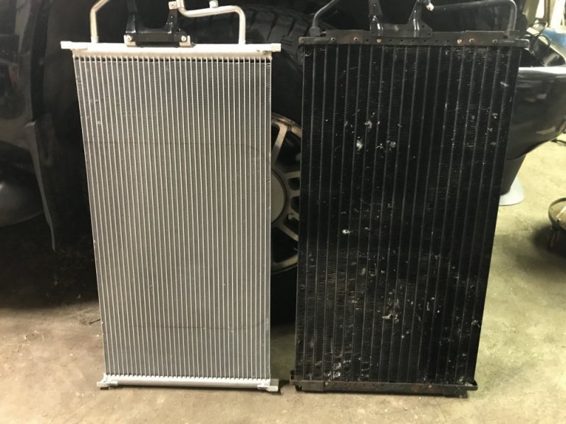

I finally have a condenser. They got the new AC Delco condenser in and it had the same problem - couldn’t get the orifice tube in the pipe. Then we opened up the Spectra Premium condenser....there was already an orifice tube in the pipe! I pulled it out with some needle nose pliars just to make sure it would come out and it did. So I walked out the door with the Spectra Premium condenser and the new 4 Seasons VOV.

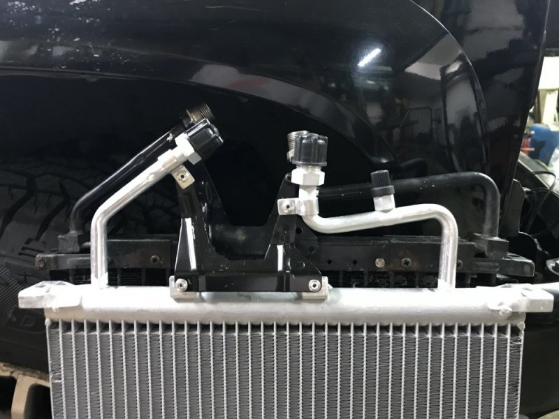

I got them home and compared the condenser to the stocker. The Spectra actually has bracketry very similar to the stock one! Huh. One interesting difference is a bung for a switch.
I have quite a few pics and more story to tell, so here are the first round of pics:
BE9D3B4D-8F4E-4215-B890-6C0271AAB497.jpeg 0714C979-D2AE-4DAC-915D-36F03064AAB5.jpeg EB1730BF-7546-4C29-A075-B2ABD4C04249.jpeg 382EB482-D7E9-4F8F-99E0-C36F97B41CD3.jpeg
D16D17A7-CC3E-4B04-A476-585E3D13EFC7.jpeg BBF8F28B-1BB5-4A30-8B85-EAE0849ACDE5.jpeg

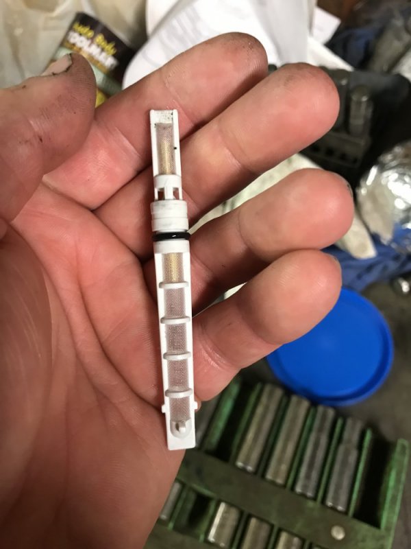

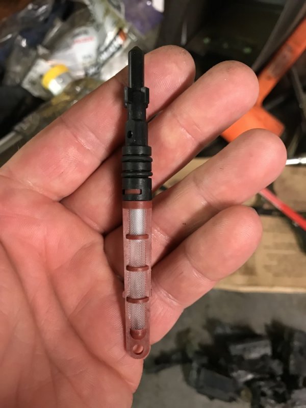

Here’s the orifice tube that came with it:
C7604E1A-38C4-40EC-9E2F-0EB573D24649.jpeg B747E26C-3EB5-4D2B-94D1-BAEDEE2FF068.jpeg
And here is the 4 Seasons VOV finally installed:
2E1EB82D-A63E-4C7F-91CF-C4C6FEDB6D8F.jpeg B1124233-AECF-4F60-A1E5-58B3DAFBC83D.jpeg

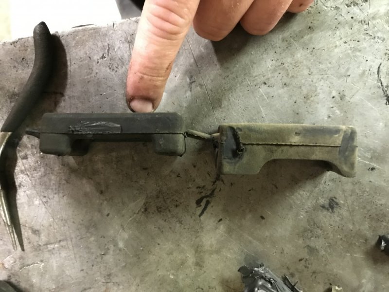

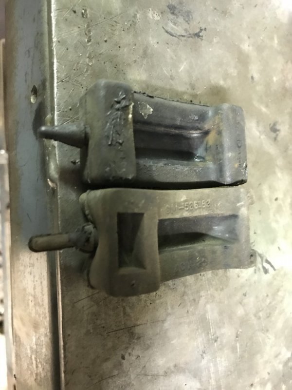

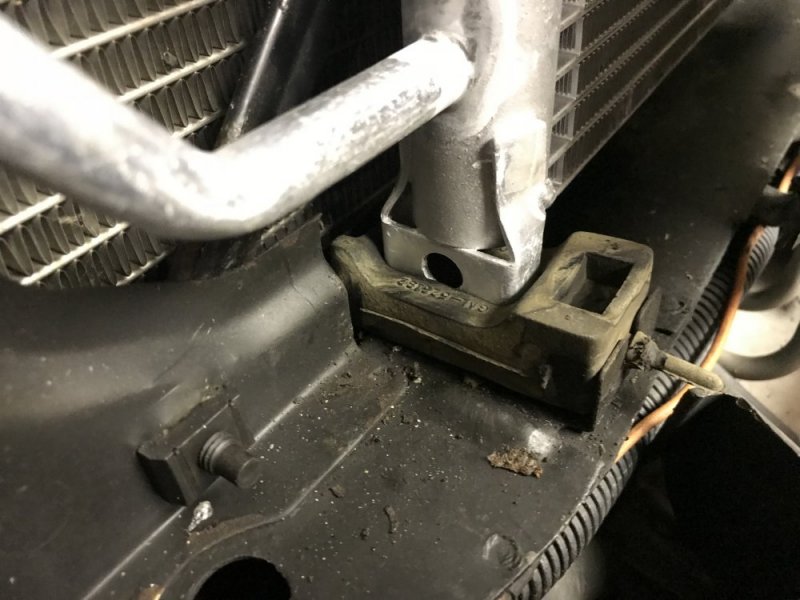

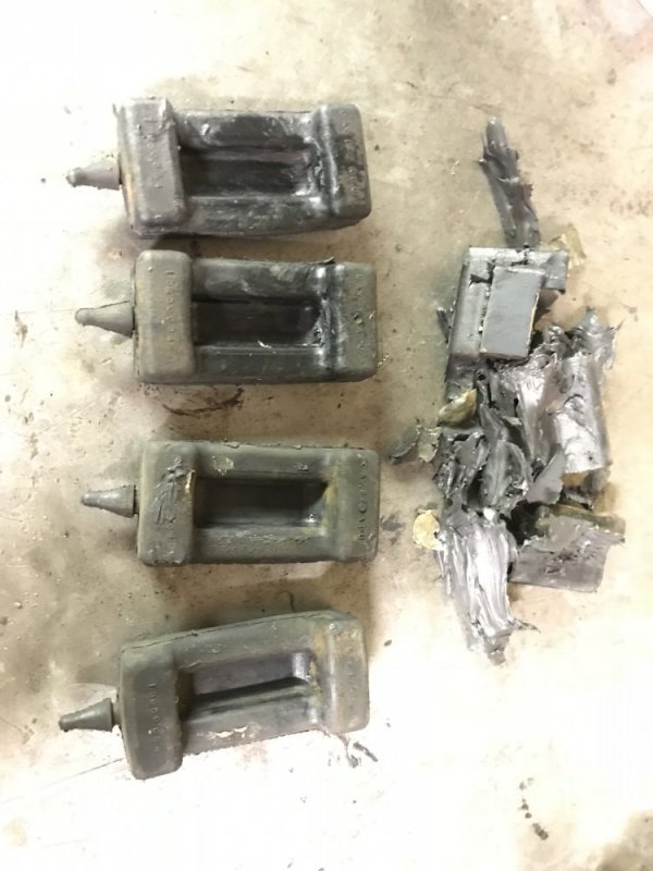

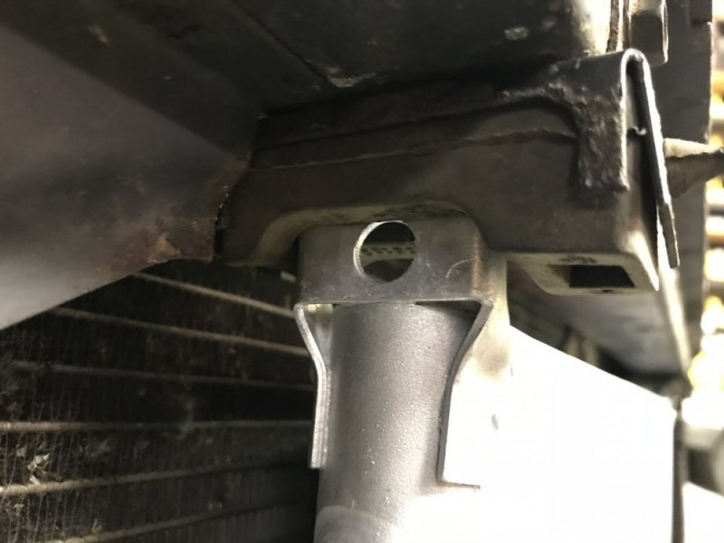

So then it was time to install it. Since it had factory style brackets I had to reverse the mods I did earlier to the cushions. Luckily they came unglued without too much trouble.

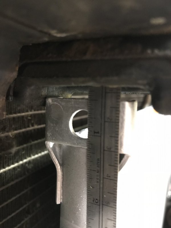

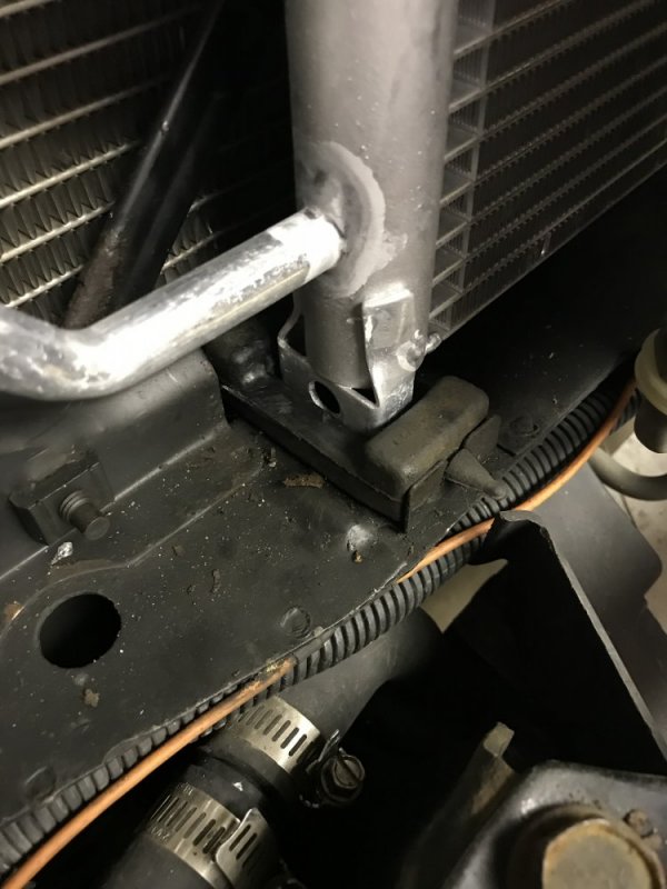

I installed the condenser and.... son of a b....it doesn’t fit tight! It’s 1/2” short!!
6781ED7B-7AD3-4C42-BBF7-FF3D2F299FF2.jpeg 8CF6EE19-352A-44B4-A23B-494AD9247ECD.jpeg

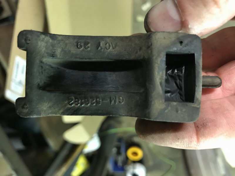

So I dug through my cushion pile and found some that looked like they would work. Yep, they worked great! I have the part number on the cushion, but no idea what I got them off of.
8E3A7D35-47A1-4CE8-B199-B1FB4BFE36A8.jpeg 08FF0D9C-8C85-40EC-B296-E4F293226D5C.jpeg
For some reason the pic came out upside down. The part number is 526182

I went home during lunch and replaced the accumulator. It held vacuum for 15 minutes.... so I started the pump again to dry the system. By the time I get home it will have been under vacuum for about 4.5 hours. All I need to do is charge the system and reinstall the grill. Then I’m ready for the next thing to break! :rolleyes:
