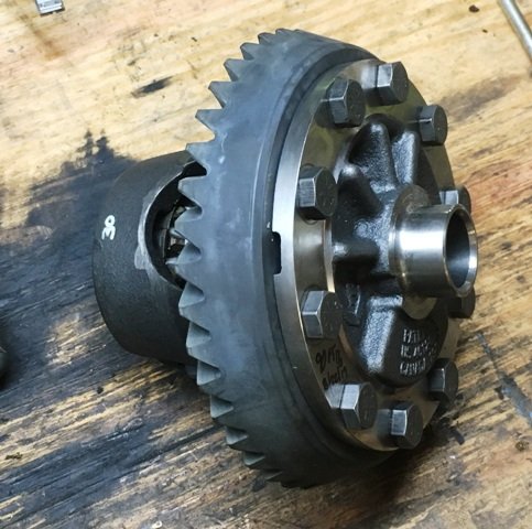

Heated new ring gear with shop heater, slid right onto carrier nicely!
New Auburn assembly fit nice and snug, added Yukon Gear bearings after, used the main shim assembly set included with bearings and had .007 backlash right from the start!
