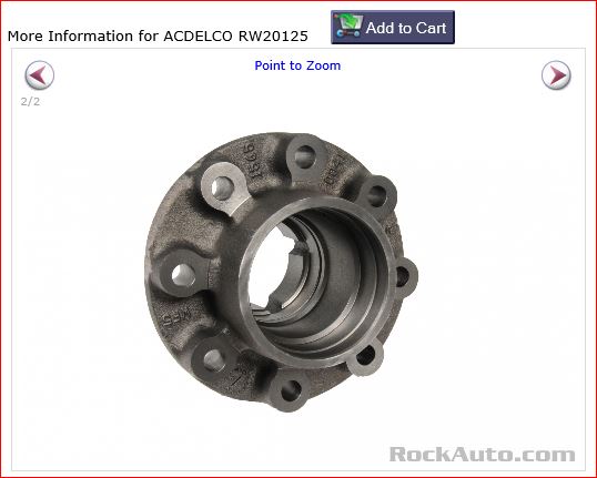

It ALMOST appears just looking at rockauto pics and pirate 4x4 pics that the difference is the drum is wider and slips over the front of the hub for wider brakes.

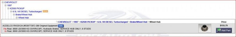

I don't see the same part numbers listed on RockAuto for those two but see some interchangeability and overlap with other C2500 and C20 etc. Or maybe its some one way compatiable. Are rear axles different for 2wd vs 4wd I wouldn't think so ???

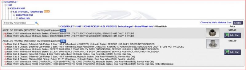

It appears according to RA the K2500 truck and K3500 single rear wheel have the same HUB part numbers.
Again it just appears the drum is different if the backing plate has same relation K2500 truck vs Suburban K2500. But can't find confirmation the axle housings are the same backing plate location.

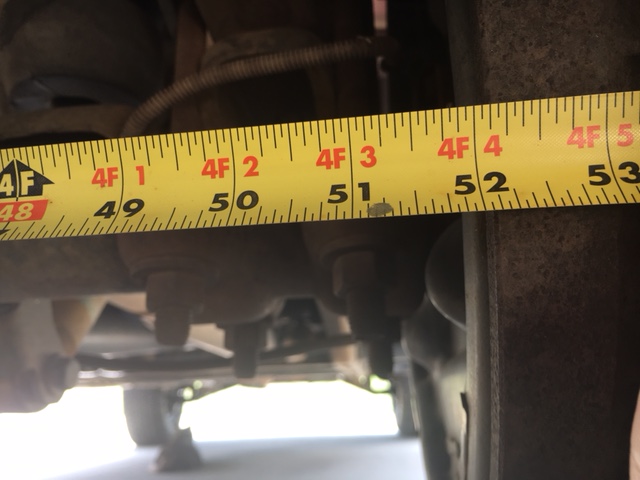

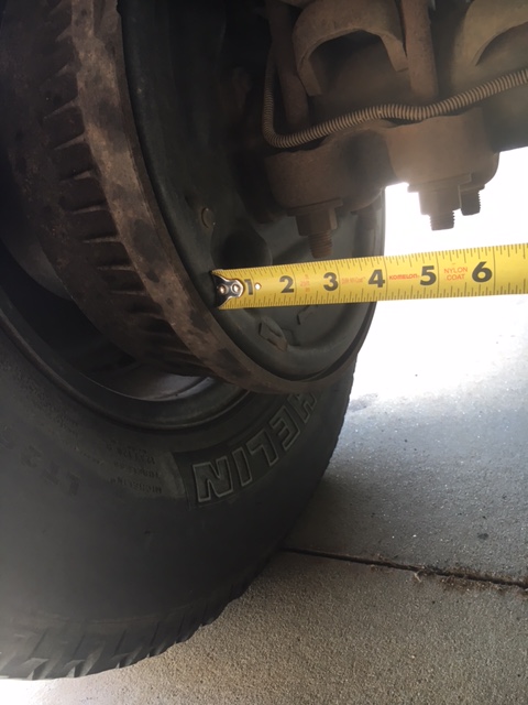

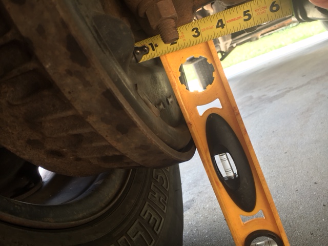

I measured my backing plate dimension as 54" of tube flange to tube flange. Measuring edge of backing plate to backing plate as 52".
Is that the same as K2500 Burb with possible 3-1/2" brakes? This does not totally define it as axles and hubs might be different length but sort of doubt it. I don't know.

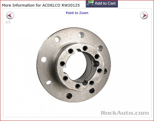

So much for rockauto pictures. If I look at these hubs for outboard or demountable drum hubs for a SRW 14 bolt it shows (2) shoulders one for drum and one for rim. That makes sense to hold concentricity.
My hub now has a shoulder for the rim to be hub centric but would not probably hold the drum concentric. With spacers my rims are lug centric.
Do other hubs maintain the OD to be hub centric for the rim I am guessing but can see a DRW inner tire being hub centric and outer tire being lug centric ?

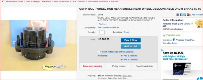

Those look like mine. I know mine are hub centric as well as my spacers. Duallys are definately hub centric as they dont use lugs with a bevel, but instead a flat washer.
