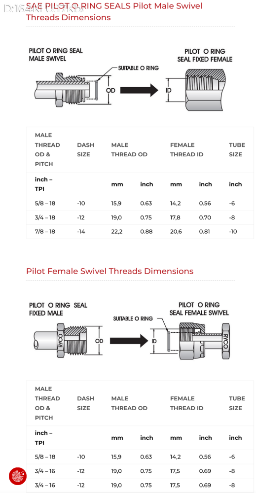

so if i read that right, i can use a SAE 45° flared female to connect to my SAE o-ring short pilot males...
so now i need SAE 45° flared females to nylon fuel hose adapters...

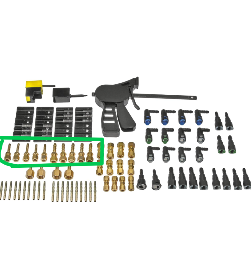

and once more i was spot on when i walked into 7 garages/shops and asked if they could fix it and that the requited parts are in a fuel line repair kit....
i remember Eric O from the south main auto YouTube channel ranting about exactly this kind of BS once, he was so spot on. thats how i knew that this type of fitting is in this fuel line repair kit. saw it once, years ago, i know about it, folks that work the stuff on a daily basis can't remember it... awesome, isn't it.
so once more those rubbish shop mechanics had no clue about their tools and friggin job....
that picture is from dormans 800-300 nylon repair kit. all parts required right there...

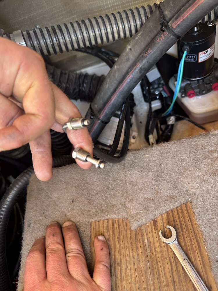

My son, just today run into this problem with His boat lower unit.
Not sure the size of these O-Ring pilot fittings but they dont fit the new hydraulic unit for the tilt/trim of the drive unit.
he needs to get himself an adapter:
SAE female 45° flare to what ever he needs on the hydraulic side.
or cut the short pilot off and use compression fittings out of hydraulics, they seem to be long enough after the 90 elbow for having compression fittings on.
make sure for compression fittings its a steel pipe, not Aluminium... compression doest play well on aluminum, especially with vibrations.... itl shrink, leak and eventually brake.

I think that in this town, most likely, He will find brass but no steel fittings.
I told Him to take the adapter fittings supplied with the kit out to the local marine shop and see if their lead boat mechanic has run into similar situations and what He did for a fix.
Be tomorrow evening but I will post his findings.
if hes cutting, put foam ear plugs into the pipe, then cut and deburr, then peel the left over half earplugs out with a needle or small pliers, that way no chips end in the hydraulic system.
make sure you get all of the plug out...
plenty of dead turbochargers around that did eat some cover rags on first start up. :p
the fitting doesn't matter really if its up to the pressure, but the pipe hes putting it on does absolutely matter. never ever put any sort of compression fittings on aluminum....
but for super low pressure system there are aluminum pipes in the market... so he needs to make sure his stuff is actually steel before converting the SAE schort pilot o-ring thingys to compression fittings...
if he uses brass fittings that's fine, as long as they are rated to the pressure the system is rated for.
better to get an adapter...
SAE female 45° flare to what ever he needs on the hydraulic units side.

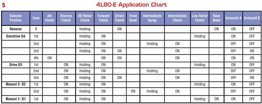

what do i need to avoid to not burn up the 3rd overrun clutch?
You can't as it's simply a weak point in this transmission.
When compression braking in manual 3rd if you ever feel a surging quit using it immediately as it's slipping and burning that small 2 disc clutch over run pack up. Transmission works normally without it: just no compression braking. There isn't much available to make it stronger.
I burnt one with a stock 6.5 diesel feeling the surging. I quit using it immediately and it would still work later.
I burnt another one up faster by forcing the torque converter clutch on, via a switch, while compression braking with a 6.5TD. It lasted 30 seconds and then never worked again. The mod(s) of keeping the TC locked during "lift off throttle" risks snapping the input shaft of the transmission. The ECM is programmed to unlock the TC clutch if you lift off the throttle.
The modification to cut the injectors and open the throttle is a good idea, but, this weak clutch may not be able to handle it.
Perhaps if you are looking at a trans rebuild you might consider a stronger transmission "project" if compression braking is critical.
