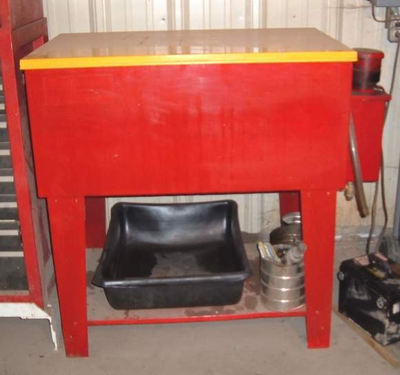

Have three pans of solvent, mineral spirits or BBQ lighter fuel for wash and double rinse. When the wash pan gets grimy, dump it into a jug, clean the pan and move that one to tie second, or final, rinse position, the pan in the first rinse gets moved to the wash position. Keep rotating the pans, cleanest always goes to the final rinse position.

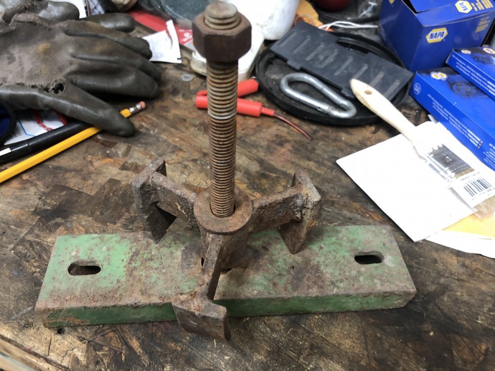

I built a rear case clutch compressor tool that I bend the arms on to fit a variety of transmissions. It works as well as any that can be had.
Home made transmission case clutch spring compressor.
Just to give You an idea of what You may need to come up with to accomplish a transmission rebuild.

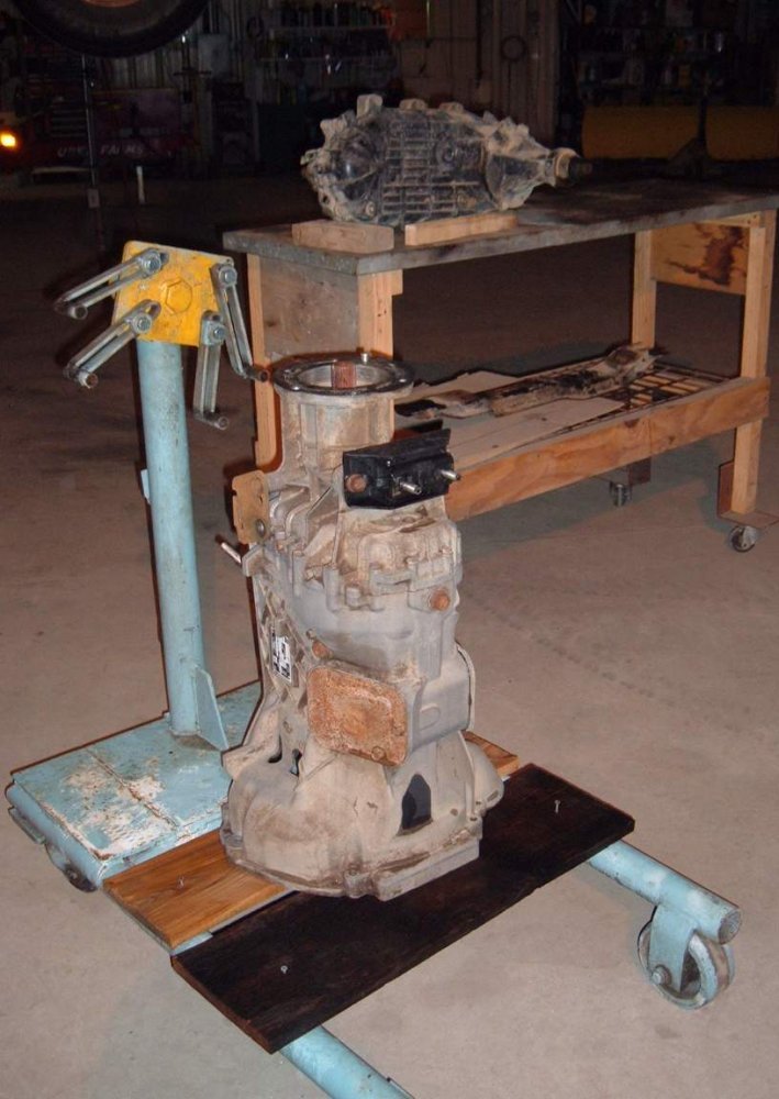

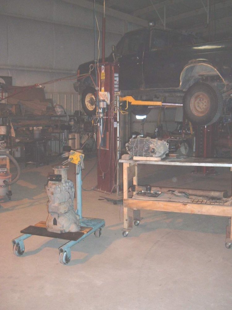

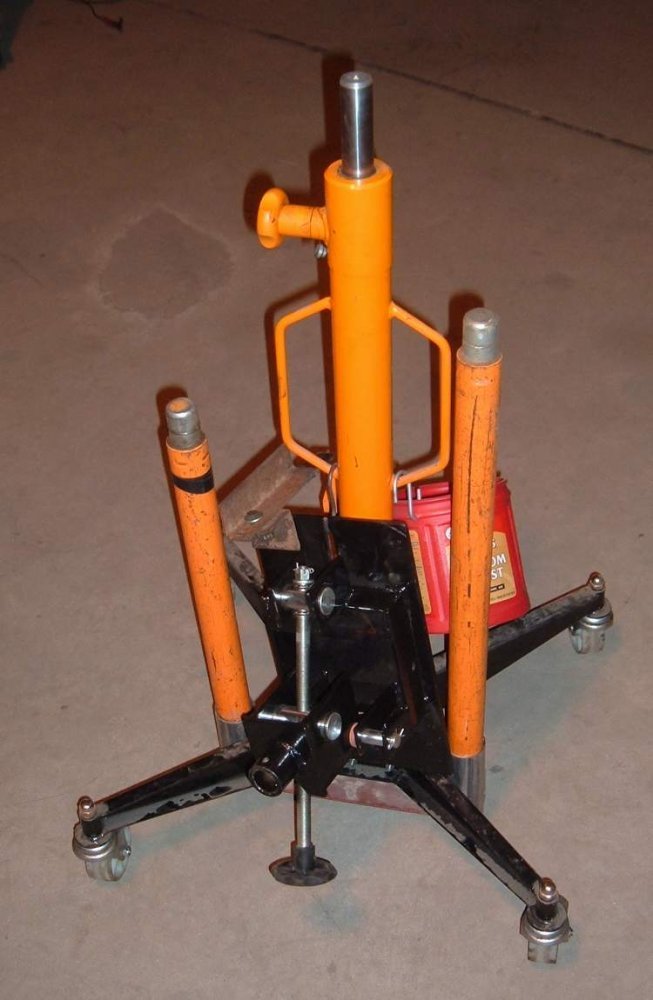

Thanks for the time estimate. In dollars it would pay a guy to sit around a week and do it then. This ZF needed 1 gear and a rear synchro I believe. Didnt rebuild it fix the thing. Did one in a mini van same way a while back, the juice was beautiful and changing the filter was a waste but we replace the torque converter and input shaft and pop it back together .trans wash stand.JPGtrans pull.JPGtrans wash stand.JPGtrans pull.JPGtranny jack.JPGtrans wash stand.JPGtrans pull.JPGtranny jack.JPGparts washer.JPG
