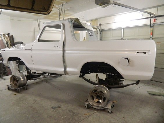

Got the engine/Trans/Transfercase set in the frame today. Set it in one piece, wouldn't want to do that with the body on it!
More room than I thought between the yoke and the cross bar for the radius arms
Finally an update!
I got the roller nearly complete, I still need to get rear rotors, u bolts and spring plates but it is on all fours!!!
The radius arms are really long, now that it has tires on it you can see how long they are.
