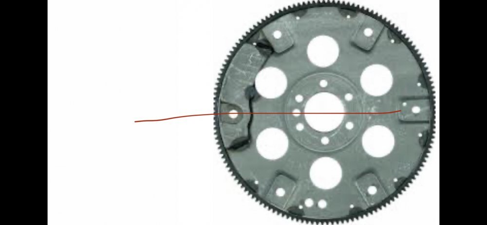

You are misunderstanding.Does that mean the 6.5 crank end is different than the 6.2 that I took a picture of? I could hardly see how you could ever misalign the dowel! While the FP might bolt on an angle, I think the bolts would be too short to catch and it should be obvious that you are not installing it in correct position - especially if you took it apart! Are you suggesting the dowel pin gets ejected back with incorrect position as FP metal knocks it back and so was missed for location? I guess you could hammer the pin in and or take a cutting wheel and cut it off. I wouldn't think anyone would do that as you would be a pretty crude engine rebuilder! I could hardly fathom someone would use this as a solution without realizing they have a problem.

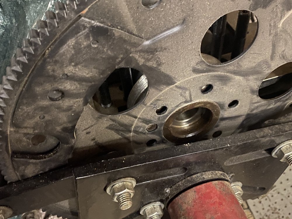

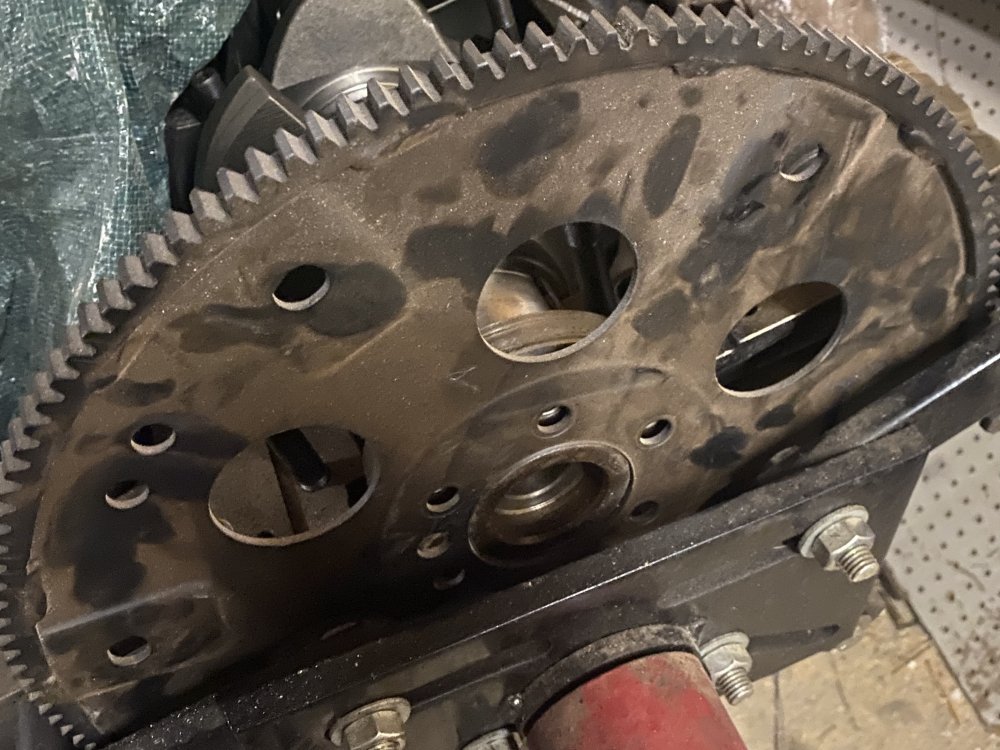

I went out to my shop, set the flexplate on the correct way took a picture. Turned the flexplate the wrong way and took a picture.
The locating pin is at the 9:00 position in both pictures- I did not move the crank.

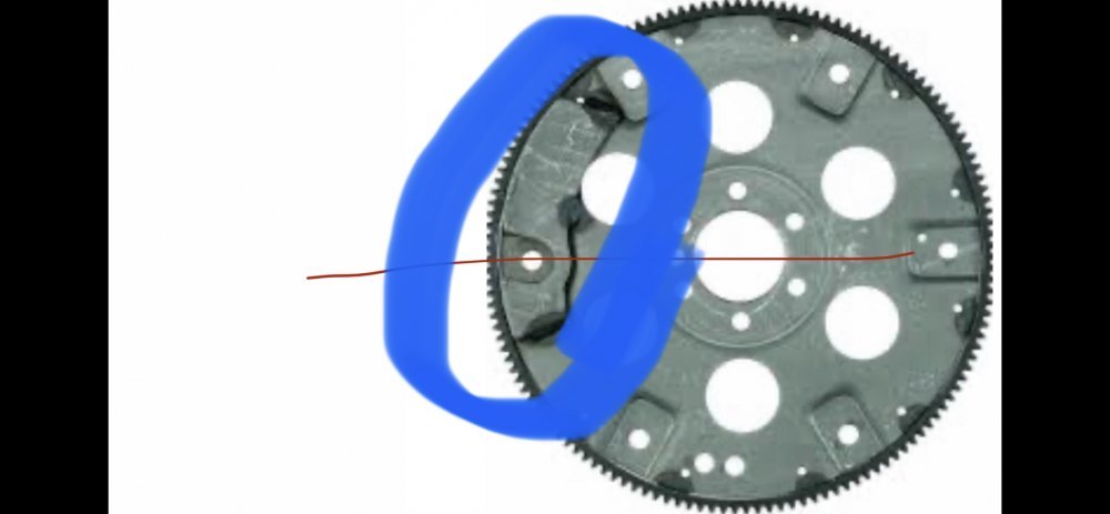

Look wt the locating pin, and look at the counter weight.
Go try the dame thing with your 6.2. ANYONE can put the flexplate on backwards with the locating pin in place.
