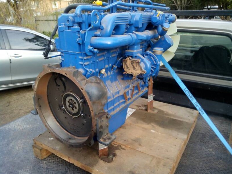

Hi everyone. Same as above am interested in how this ended up. I have a new Detroit 638 that I have fitted to a used tremec T56 transmission. Torque isn't far off the limit of the box, but wasn't to be a problem in the original truck it was to be fitted to. Now looking at slightly bigger truck, and more towing, trying to decide whether to use the Detroit or go a Cummins 6bt and Eaton 6 speed - more torque, not going to break the box.
Located Australia - these motors never officially made it here in a vehicle. Were imported in mechanical form in a Kia bus.
Mine is still bolted to the original pallet, wiring loom, ecu and electronic throttle...

So from what I understand there is two versions of this motor. A full mechanical pump which will have a lever on the side of the injector pump. All you would have to do is hook a cable up to that and to a throttle.
The other one is more common I think, which is electronic over mechanical injector pump. There will be two sets of wires coming off the pump from memory. This pump requires the electronic throttle, although it doesn't plug directly to the pump, it plugs into the wiring loom. Will post a pick of mine. And email you pics of the throttle.
