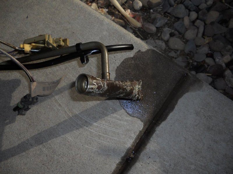

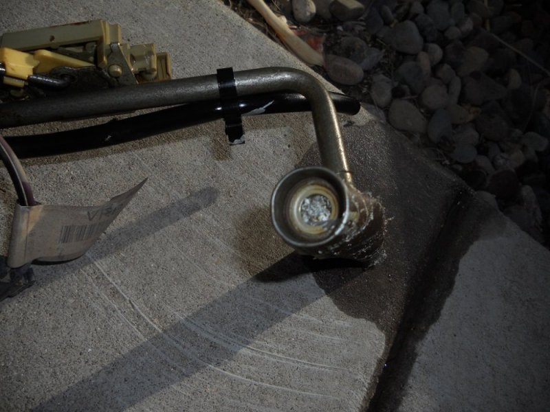

The reason he brought up the tank sock is because there is a difference between the gas and diesel ones. Most 6.5 owners that replace their tank sock replaced it with a gas sock not realizing there is a difference. The diesel sock has a bypass built into it.
I truly don’t know about the sock. my fuel gauge didn’t work, I had him fix it and put a new sock in too. It worked good for a coupl of years, wou it take that long to clog a gas sock? It is my daily driver, i also have taken a few trips towing my fifth wheel rv since then without any problems. I would have to drop the tank to find out I guess. I might could find the invoice from the shop.

Pictures are of the DIESEL sock with the gelled fuel bypass valve in it. Gas socks do not have this. The silver strips clogging the works up are the lining of the tank coming off due to Biodiesel ALL of our diesel is now spiked with.
