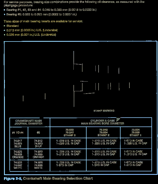

Just to cover all the bases - what others have coined as "select fit" bearings is a rather significant point in regards to the 6.2/6.5 engine! These blocks are machined green (IE, still glowing hot after being cast)!
The main bearing saddled's center to center, center to deck, and concentric dimensions are all over the place after the blocks cool down. So the craptacular engineering solution gm came up with is using different under/over-sized bearing shells.
Not only between journals, but also between upper and lower shells on the same bearing! GEP applied color coded paint dots on the block's oil pan walls to help identify the sh!tshow of mix & match parts. Otherwise, you have to meticulously write down each bearing's location shell numbers (top & bottom), per main and rod journals to ensure getting the right replacements!!!!!
@94DieselSub if you have any info on the exact meaning of the paint markings it would be most welcome in the reference section.

I wish I could say I can metally keep all of the details straight - but. So in talking with Peninsular, they explained GEP's bearing color dots scheme to me years ago, but those brain cells are long gone. I went the hard route an wrote down each shells #'s as I removed them from the Optimizer. Sorry I couldn't further assist the info pool.

For the color chart see the attached PDF, page 2-5 ---- well the file is toooooo large and won't load, this info is in the "6.5 diesel student hand book" it might be in the sticky's somewhere...
I attempted to copy and past the page here but it didn't work so well...1578525273474.png

Thanks for sharing the data sheets!
Although, I did notice the over/under sized options were very small deviation from the std spec. For new builds perhaps GEP tries to adhere to only those? But for mil reman's, I could if sworn I seen p/n's for +/- 1 & 2 thousands and possibly even larger.
Also I believe there was more than just four color codes. The select fit sets Peninsular threw together for me had all kinds of different sizes (all GM p/n's). And this was for a 2005 Ted's-cores pullout Optimizer.
