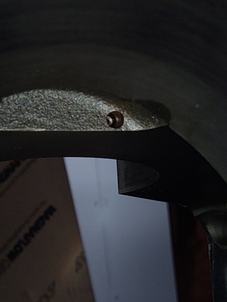

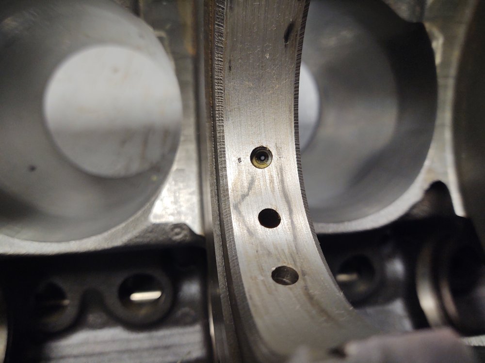

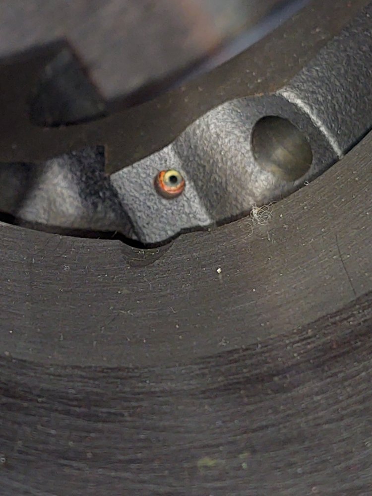

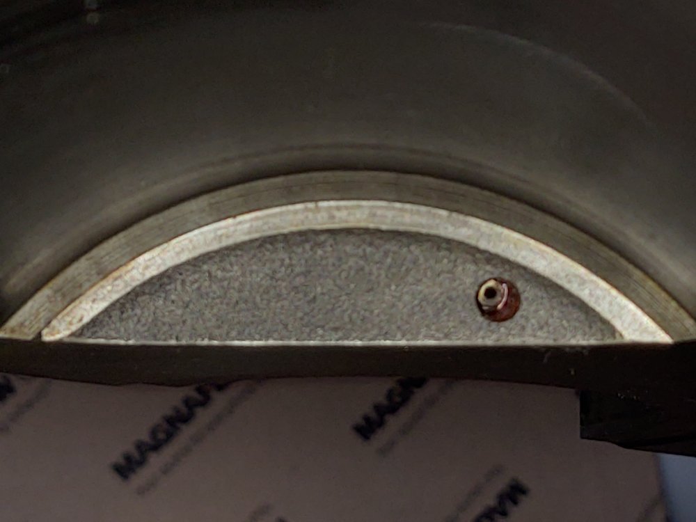

93detroit Well-Known Member Messages 311 Reaction score 877 Location central PA Dec 23, 2024 #21 My '06 block has them, but they were blocked off by main bearings for a non-squirter block. It also had the standard volume oil pump. I will post pics of the block when I get home.

93detroit Well-Known Member Messages 311 Reaction score 877 Location central PA Dec 23, 2024 #22 Notice that cylinders 8 and 1 are machined to allow a straight shot to the piston. Attachments IMG_20241223_180247014.jpg 99.6 KB · Views: 11 IMG_20241223_180135329.jpg 54 KB · Views: 10 IMG_20241223_180040262.jpg 68.5 KB · Views: 11 IMG_20241223_175659299.jpg 80.5 KB · Views: 11
Will L. Well-Known Member Messages 20,965 Reaction score 42,647 Location Boulder City Nv Dec 25, 2024 #23 Thanks! Looks same as what I remember from the old gm blocks.
