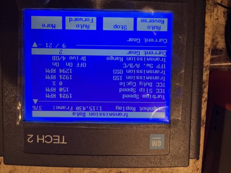

You are our eyes and ears to see what is going on so we can help. Thanks for the info. The input speeds look ok so engine RPM and trans speed sensors are working. As an aside IMO it's a little off but NOT the trans problem: What is the engine RPM supposed to be? Should be on the emissions sticker both cold with cold advance and high idle on and hot idle.

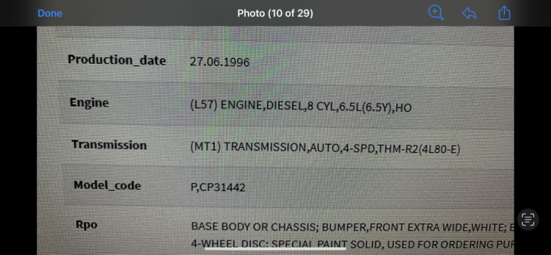

Here is the build info

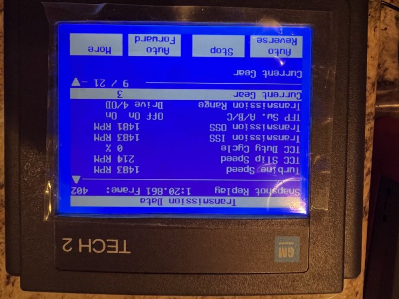

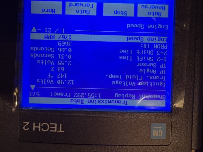

I messed around with the truck today it seems the truck shifts upto 3 gear but does not shift beyond that. I had the tech 2 hooked up and shifted through the unit with now problems through all the gears just won’t do by itself
Did you measure the voltage and confirm with a meter what it really is?
Aside of that something mechanical in the transmission needs to be "fixed". This is the code "85" commanding 4th and it's still in 3rd.
The truck has no codes at all now voltage is 13 volts. Batteries needed charged Won’t go past 3rd grear on its own using the tech 2 shifted through all the gear no problem

Is it saying "Gear Commanded" 4th on the Tech 2?
The rev out without shifting may be something we are missing and it's in limp mode still.
As you have other gears the "electric" is all working. Something is "broken" in the trans where it won't mechanically shift to 4th. My first 4L80E in the 1993 went "BOOM!" Crunch Crunch Crunch when it "lost" OD/4th. Took a rebuild and some hard parts to fix it.
You have 4th selected not 3rd as a misadjusted linkage could do this. "N" would be OD/4th then.

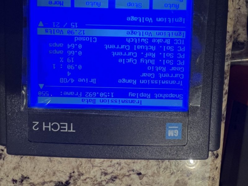

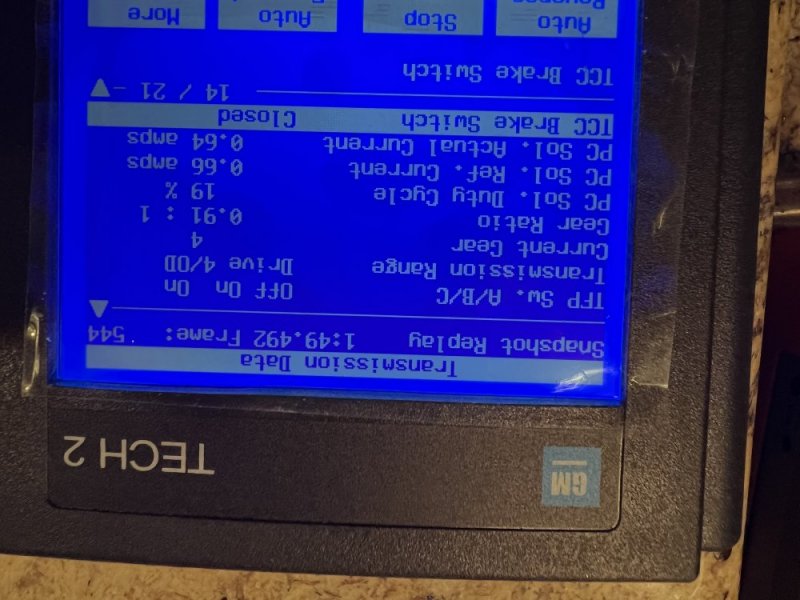

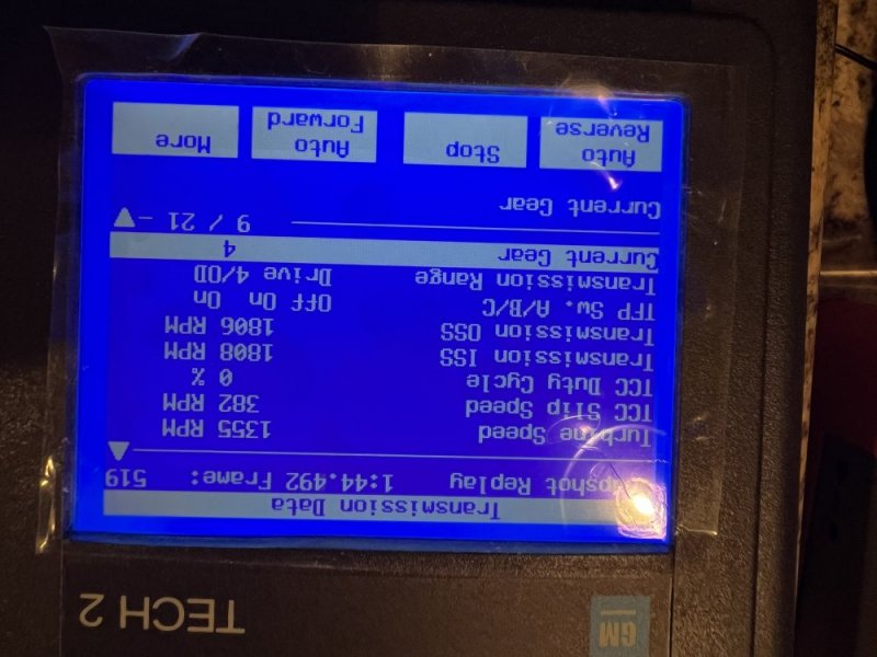

It shift into 4th with the tech 2 when I take it on a test drive I watch it shit up to 3 gear then I shift up with the tech 2 it going up a gear for sure cause the engine is not reving high and I’m doing 50mph in a step van

So you force it to shift to 4th with the Tech 2? Or does it shift to 4th with it plugged in?
Does the TCC ever lock up?
